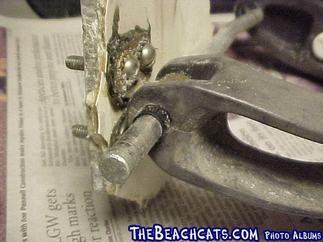

bobflesh wrote: I found on my sail this weekend I had to pull them loose way in advance or risk not releasing them in time.
Unfortunately that is normal with the pre-1987 castings on the Hobie 18 after they are 30-plus years old. The metal cam gets messed up and no way to really fix it although some have tried.
Either be very careful coming in through the surf or upgrade to the newer castings.
http://www.thebeachcats.com/pictures?g2_itemId=10836
or end up with this
Posted : July 28, 2015 10:26 am
