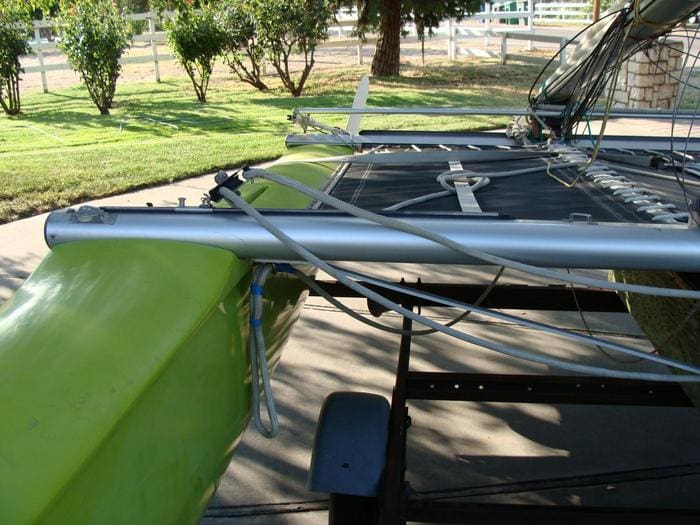

Here are some photos showing what my traveler, I guess it is standard.
<img src="/wp-content/uploads/images/64842.jpg src="
We saw this when we got home. Is this a major concern?
This is the jib block with the outboard pully. It looks to me like the pully was put on backwards.
inboard of the track is a jam cleat for the sheet for the opposite side.

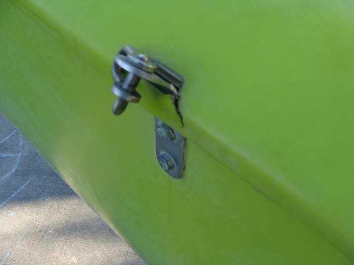

When we got home my elder son noticed this crack. There is another carck on the other side of the same attatchment. The other hull has no problem with this. Is this something that should be taken care of right away. I think it happened when the shroud busted, but I'm not sure I don't remember it from before.

Re your jib track, I have a few guesses as to how its suppose to work but thats all, hopefully someone more experienced can chime in. My Solcat is set up the same way except there is no jam cleat.
As far as the crack - yep i'd repair it as soon as possible. Even though there is much more boat taking the pull of the shrouds, every bit helps and I wouldnt want to risk it.

Regarding the jib block location you can set it for the conditions of the day either inboard for hi wind day or outboard for light wind or you can find a happy medium set it and enjoy the sailing. You can set up the jib blocks to be more adjustable when you are sailing but I have found I didn?t need to make many adjustments once on the water.
As far as the crack in the hull goes it is not a structural issue as the bridal tang should take all the loading, I would take the tang off and try to bend it back slightly oh so gently so it does not touch the rails when you are fully rigged, maybe squeeze a little epoxy or good water proof glue into the crack in the fiberglass and clamp it until it dries and then bolt the tang back on that way you don?t mess up the green paint/gelcoat so much. I have had a few solcat and it seems that they all have had the rails cracked. I still love mine. Great boats.

I have a similar setup on my H16, a bungee/shock cord is attached to both the jib blocks with some tension, connecting them together, sheet line is attached to outside of jib block, runs through cheek block, pulling on line moves jib-block out for down-wind sailing, release line and bungee tension pulls block in to original position. You just have to work out how you want to cleat line off to hold block. I can't post a pic because I don't know how the frack to do that.

The shock cord was attatched to the peg that locks the block to one place, I didn't think this was good because of the possibility of bending the post. That jib can put a lot of pressure on the block. I'm thinking of an alternate method of attatchment.
