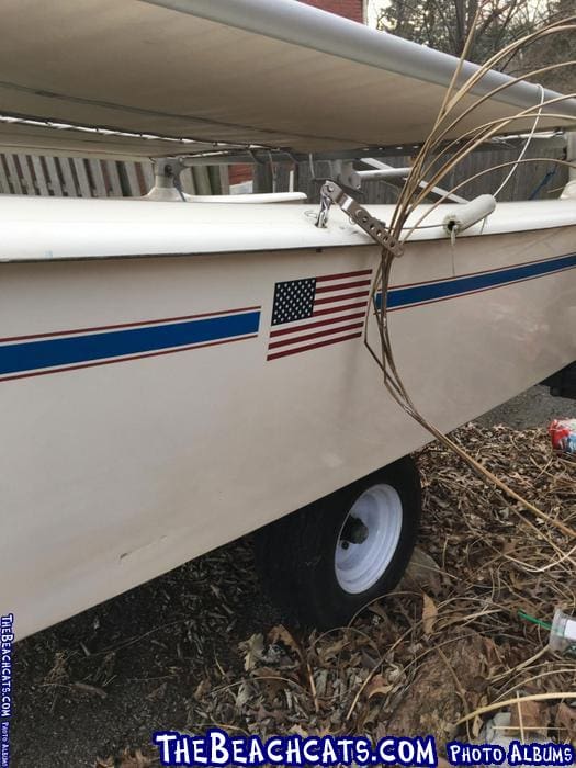

The bicentennial edition just had the stars and stripes sails as seen in my avatar and a flag decal on the hulls.
the tramp is original (as is most of the boat) and though it seems to be in fairly good shape the hiking straps are shot so its going to get replaced anyhow. The guy I got it from did replace forestay and added aussie jib halyard and changed out the main traveler. there seems to be a lot of slack in the shrouds so im planning on replacing them. to achieve more mast rake I assume I need the newer length shrouds.
the trap gear had been removed at some point. I have some various pieces but it all needs replacing.
jib sheet and clew blocks needs replaced and im already fed up with the stock jib blocks/cleats beat the tramp to death trying to uncleat! on that note the I have a broken cleat on the mast. cant remember what one at the moment. and the part I dread the most is getting some cat traxx!
the Hulls are in great shape though!

upon further research my boat is a Spirit of '76, posted a few pics in an album but I can't seem to rotate them.
(when I try they wont show up)

Fixed your pictures. One of them was a PNG which still should have been ok and not sure what was wrong with the others but I couldn't rotate them either so just downloaded them, resaved them in Photoshop and uploaded back to your album.
Lost your titles and descriptions but you should be able to edit them since you are admin for the album.
