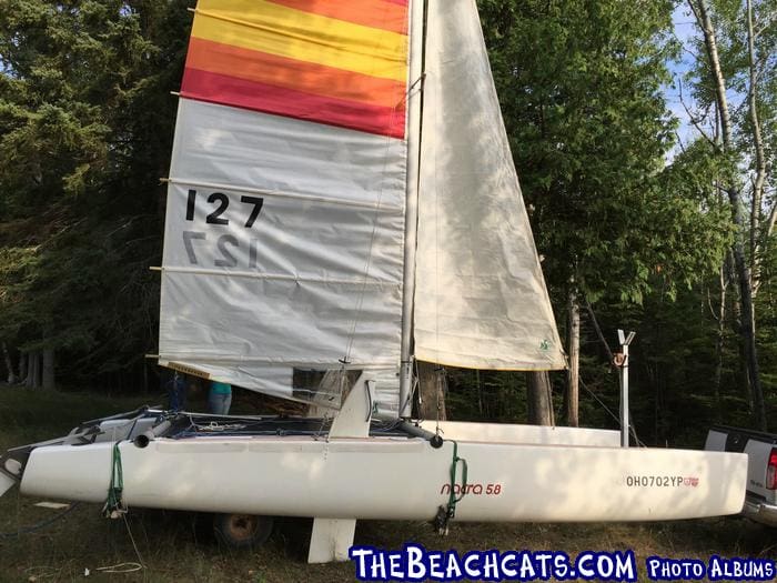

I just picked up a 82 Nacra 5.8. Bit of a project but not too bad, hulls are in good shape. Original sails look like new. Hulls had a couple places needing some glass work. One daggerboard was in good shape the other one needs to be rebuilt and is in process. I'm going to re-gel coat the boat next. I have been around sailing quite a bit but never owned a cat. I will need some help at some point with rigging, specifically main downhaul and mast rotation setup. I think I have most of the rest of the basic setup covered. But that will be a little while yet.
This is an older picture of the boat.
This is the day I brought her home.

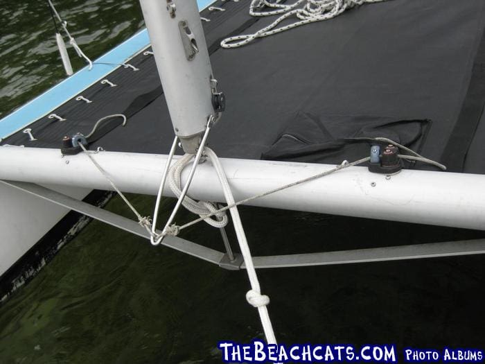

The mast rotator is the other question I have, if you can weigh in on that, there is one pulley on the wishbone and each side of the cross beam has a the same hardware.
You just need a bit of line. I removed the rotator from my 5.7. It was useful downwind, but I'm not racing, & so don't care about an extra minute. It was also useful to prevent the mast from flopping around in flaky wind & shaking the air out of your sail. However, you must remember to release it as your first item. If you don't, you risk breaking the mast in big wind. If you are in a hurry to get on the water, ignore it for now, the boomless rig will self rotate except for downwind. I initially rigged like this;
That is a pretty crappy way to rig it though. Later on I went to a continuous line. Deadend at the eyestrap on beam-to end of rotator- back through cleat- around behind mast-through opposite cleat-to rotator-deadend on eyestrap.
That gives 2:1. I think i used 1/4" line, there is a fair bit of twisting force, & the 1/4" was easier on the hands.

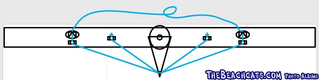

If I follow it, this is what you were describing, does this look right?
Posted : September 27, 2016 9:12 am
(@pm)
Posts: 3376
todd1016 wrote: If I follow it, this is what you were describing, does this look right?
Yes, and you don't need turning blocks, just some 3/16" line and you're good to go. Ed's spot on on the rotator and downhaul. Now if you want to trick it out, get an over-rotator and 16:1 downhaul. You can see pictures in my album doing it both ways.
