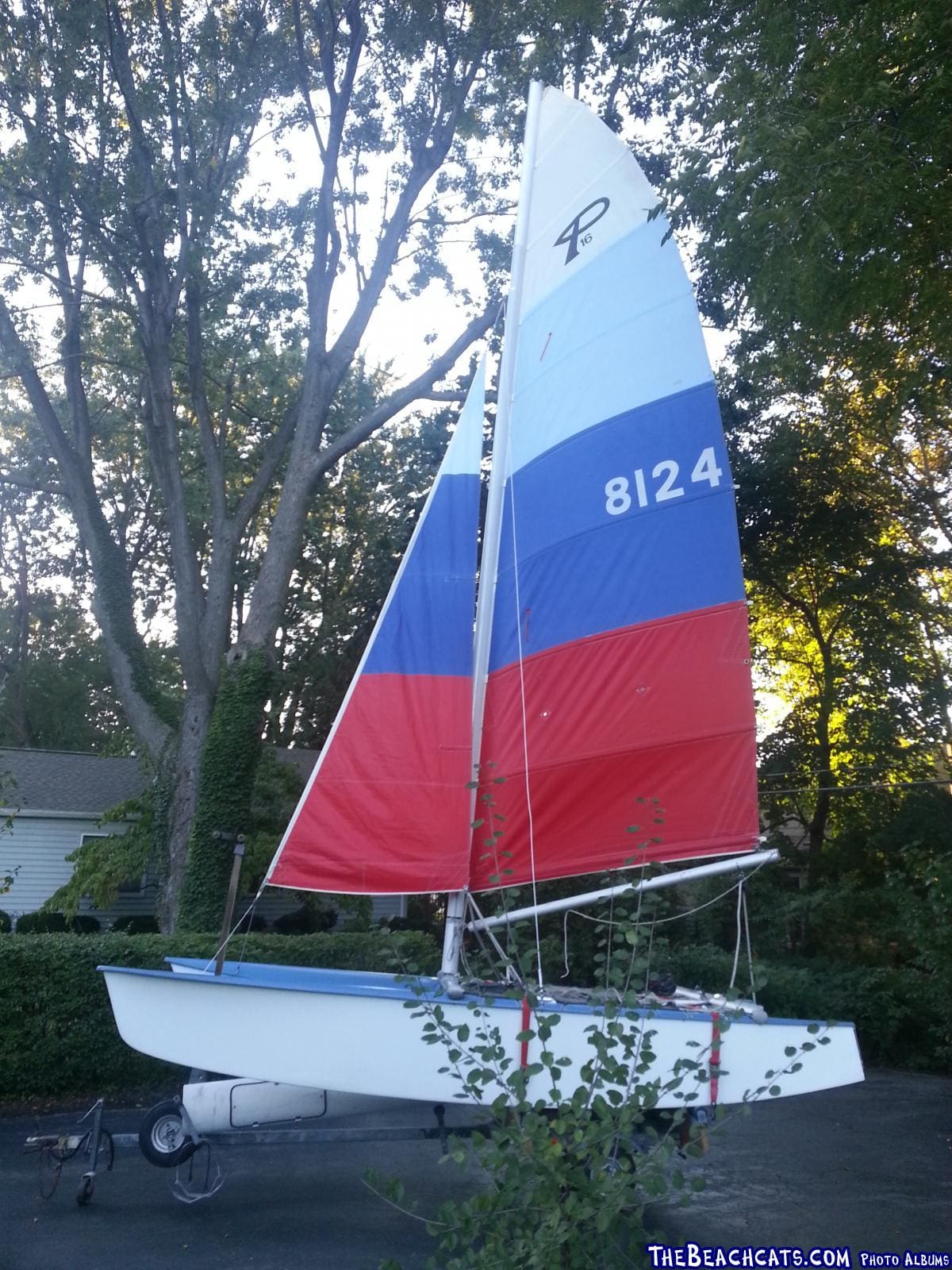

rwj0j0 wrote: Post some pictures of your boat...
Here it is - still on the driveway though...

It is not going to sink.
Your boat looks great! Looks like she was hardly used - can't be sure without better pictures but there is very little wear
Take her for a sail!!!
Your trailer configuration however leaves a lot to be desired. You need to fix that.

rwj0j0 wrote: It is not going to sink.
Oh, it was used enough to have a visibly uneven patch job on one of the hulls. It was painted over though, so it must be alright 😛
rwj0j0 wrote: Your trailer configuration however leaves a lot to be desired. You need to fix that.
That's what I am working on right now. The previous owner - the one who never got around to putting it in the water - built the trailer himself. He used 2x6 lumber for the frame, which makes the cat sit at least 4" higher than it needs to - I plan to remedy that with some steel frame tubing at the first opportunity.
That's not the biggest problem though - the mast mounting hardware did not survive the 5 mile delivery from his driveway to mine. He used a Hobie Mast Caddie split into two. The top part of the Mast Caddie (the mast clamp) was mounted on top of a 2x3 piece of lumber that cracked when I tried to remove the mast from it. The bottom part of the Mast Caddie (the rear crossbar clamp) was fashioned with some loose wood pieces in a way that endeavored to clamp the mast to the crossmember directly. That mound fell apart in transit, so now the mast has some minor dents in it (at least it still looks pretty straight though) where it was clamped by the top part of the mast caddie and where he tied it directly to the crossmember without any padding.
I plan to keep using the mast clamp from the deceased Mast Caddie (it's too broken to put back together) as the top of the mast stand, except that I am using a 1.5" galvanized steel pipe instead of wood. For the rear, I plan to use some thick (4" or so) rubber padding that I will gouge out cross-wise on opposite sides so as to rest securely on the crossbar and provide a resting spot for the mast. I intend to use some bungee ties to secure the mast to the loop (the nautical term escapes me at the moment) that is used to tie off the traveler end of the mainsheet.
Also, he had a ridiculous contraption to secure the sail tube to the trailer, that is certainly getting redone. There are actually steel loops that come with the sail tube that he for some reason elected not to use - I will screw those to some steel joist braces and then screw the joist braces to the 2x6s while I have them. When I get the 2x6s replaced with steel frame tubing, I will secure the loops directly to the frame tubing with through bolts.
That's all I can think of for trailer updates - but I am more than open to any suggestions. This is the first boat trailer I ever owned, so I am sure I could learn a thing or five about how they should be put together.

You need to change the geometry of the trailer.
You need the front trailer crossbar to be much further forward.
When you strap a cat the straps should be behind the aft cat crossbar and in front of the forward cat crossbar.
diagram here:
http://www.thebeachcats.com/news/34/trailer-and-sail-tube-construction/

dude...our sail numbers are four digits apart and the same color...
Well, that is my second sail anyways. I generally use the one in my avatar because it matches the boat better, but the 8140 sail is a lot newer and in better shape.

vinnyvincent wrote: dude...our sail numbers are four digits apart and the same color...
I was wondering what the number's significance was... Is it the boat's original sail then? I would have thought that in the intervening 30 years at least one set of sails would get used up. Or are replacement sails by convention affixed with the original number?

rwj0j0 wrote: You need to change the geometry of the trailer.
diagram here:
Are those dimensions for a Prindle 16? Or a 16' cat in general? Do I need to find out what the precise dimensions are for a "genuine" Prindle 16 trailer? Am I to consider myself lucky that the hulls did not (HOPEFULLY!) crack in the 5 miles that the previous owner drove it to my house with incorrectly positioned hull supports? Should I absolutely positively not put it on the road like this lest I damage the boat, or is it simply a good idea to get the trailer to support the hulls wider?
I actually paid money for the trailer under assumption that it was in fact somewhat matched to the boat and was used to transport it on multiple occasions, but now that I know that it was transported exactly once (to my house, and with questionable results at that) I have zero confidence that this trailer is suitable and would certainly appreciate some guidance on figuring that out.

Whether its the original sail that came with the boat, I can't say for sure. It was the only sail that came with the boat when I bought it. The white and blue sail is a spare sail that I had left over after I ditched the junk hulls and bought the blue boat you see in the picture with the 8120 sail.
someone correct me if I'm wrong but I believe the numbers on the sail signify what numerical order the sail was produced by that particular sail maker. in our case our sails were made by the original manufacturer of prindle(surfglas, which doesn't necessarily mean they came with that boat or any boat). If you were to purchase a sail from an aftermarket sail maker and it was only their third prindle 16 sail they ever made, your sail number would be 3.
Judging from the amount of prindle 16's produced and the condition that mine is in, I'm going to go out on a limb and say that my 8120 sail is not likely to have came with my 1984 prindle and is probably newer. I'd be willing to believe the white and blue sail in my avatar could have very well been the original sail that came with my old 1982 P16 as shown, but can't say for sure.

mgoltsman wrote: [quote=vinnyvincent]dude...our sail numbers are four digits apart and the same color...
It seems most of these boats come with their original sails.
Your sails and Vinny's sails most likely came with the boats - I believe sail numbers were sequential unless custom ordered.
mgoltsman wrote: [quote=rwj0j0]You need to change the geometry of the trailer.
diagram here:
I wouldn't take it on the highway like that for sure - its not about the boat either - its about killing somebody else.
I have 3 trailers - two are the same model - one is different. The oddball is a "little dude" and the other 2 are ezloader sprints. I hauled the NACRA 5.8 150 miles on one of the ezloaders without adjustment - no issues. The dimensions are general for beachcats that are 14-20 feet in length most likely. The width is very standard and is either going to be 8' or 8'6" for the vast majority of cats - of course you have your 18^2s - tornadoes and other super wide cats.
I think you can totally make the trailer you have work and only spend a few bucks doing it - so no need for buyers remorse!

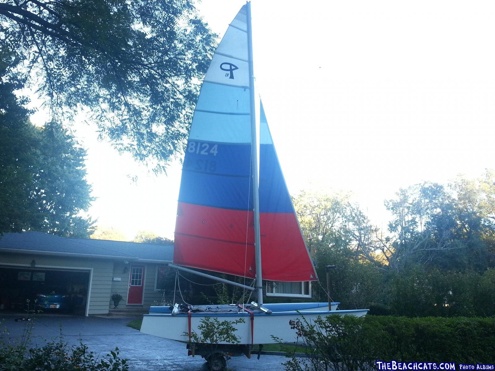

Agree that you can probably make adjustments, but will need more pics of your trailer. Looking the picture you posted, just move the bush. 😀
Actually, is that a bow stopper about halfway down the trailer? You may have a converted jet ski trailer.
Add some pictures to your album of the trailer cross bars and axle and how they are attached to the trailer.

DamonLinkous wrote: Actually, is that a bow stopper about halfway down the trailer? You may have a converted jet ski trailer.
That IS indeed a bow stopper, and judging by the size it is indeed a jet ski trailer. There should be no problem with weight rating and what not, but I will have to assemble a better (longer) frame for it. four bars of galvanized 2" box tubing (two across to provide the proper width and two along the hulls) should do just dandy. I can manage the width based on the current configuration that fits the rollers precisely under the hulls, but would appreciate suggestions for the necessary length to properly support a P16.
Here is a better view:

What are the existing cross supports made of? They appear to be like wood 2x6's ?
I would keep my eye out over the winter for a genuine beachcat trailer and sell that one on craigslist I think.

Ugh, looks like I really pood the screwch with the trailer... I just walked up to it and lifted one of the hulls with my hand (the cat is tied to the trailer), and the trailer is WAAAY too wobbly to put on the road - the wheels are too close together (4 ft maybe) to support a cat. I was planning to pull off the 2x6 lumber and replace it with a wider and longer box steel frame, but I think it is too much trouble to move the wheels farther out. I will probably have easier time adapting a wider boat trailer to my cat.
I doubt that I will be able to find a cat-specific trailer in my neck of the woods, at least for less than what I paid for the boat itself. There are far more cats without trailers than trailers without cats on craigslist. Especially over the winter - nobody trades boat trailers in the snow. But taking a wider trailer and adding the necessary beams to it should not be a big problem.

how far apart are the wheels?
I'm not sure it matters how close together they are as long as the trailer is well balanced.
The "little dude" trailer has small wheels that are close together - I can measure and snap a picture later today

rwj0j0 wrote: how far apart are the wheels?
Between 3 and 4 feet i would say. If it is the latter, then it matches the 48" on the diagram... Someone suggested that with a narrow wheelbase it is all too easy to tip the trailer over on a turn, and simly lifting up one of the hulls seems to bear it out - it feels tippy. That said, the dude that welded the trailer on the diagram seems to know what he was doing so maybe it is safer than I think as long as I don't screech down any clover leaves at 50 mph while towing the boat. I suppose I could put little sidecar wheels under the hulls if I am too nervous about it, but it's rapidly getting to the point where I am better off finding a bigger trailer.

mgoltsman wrote: Ugh, looks like I really pood the screwch with the trailer... I just walked up to it and lifted one of the hulls with my hand (the cat is tied to the trailer), and the trailer is WAAAY too wobbly to put on the road - the wheels are too close together (4 ft maybe) to support a cat. IEdited by mgoltsman on Sep 26, 2013 - 09:01 PM.
My custom made trailer's wheels are only about 4-5ft apart. It has two pieces of steel U-bolted across, with rollers bolted onto the ends that to support the boat(you can get these at any boating or outdoors store)
come to think of it just about any cat trailer I've seen has the wheels set at only about 5ft apart, give or take a little. Even the real deal "cat hauler" trailers I've seen are like this. If you put them much further out than that, the wheel wells hit the hulls.
it's not like you're hauling a motor yacht, its a 290lb boat. Thats less that half of what a jet ski weighs. I can lift my whole trailer up, with the boat on it from the rear and have done it to pivot it when backing into a tight spot. The reason it is so easy to lift the hull on your trailer is because a majority of the boat is sitting in front of the axle.
Un-strap the boat, slide it back about 3ft, so that the front strap is just in front of the crossbar, get the thing insured for 100 bucks and go sailing! Save the trailer fabrication and messing around with a hair dryer to find leaks for the winter. I know plenty of people who sail with pretty bad leaks. just keep your trips short and drain the hulls in between outings. You need to determine what is actually a problem before you try to fix everything.
both your boat and trailer look like they are in great condition from the photo's. Take a picture of the rear so we can see where the wheels sit in relation to the boat hulls.
