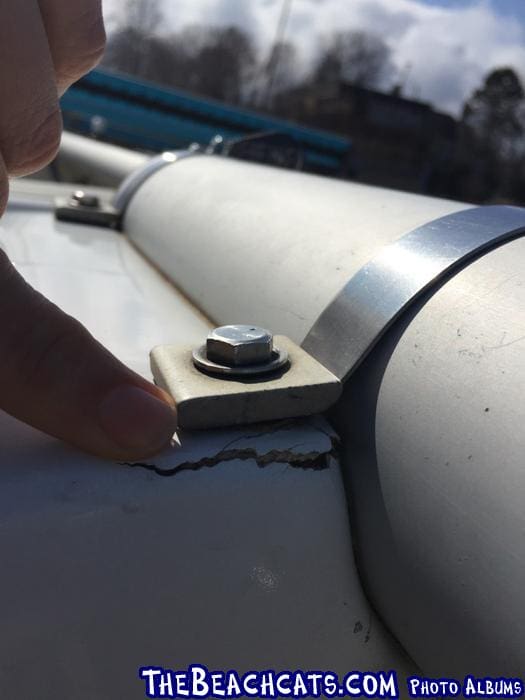

Hi - I want to get into cat sailing and have been looking for an early 80's H18 or Nacra 5.8 for use on the great lakes. I have a possible old Nacra5.8 lined up that seems to be in decent shape but I have noted some issues that I'm uncertain about - I just don't know whether they are a big deal or not. Any opinions?
Here are the issues I see:
1. Inboard strap on the forward crossbar has cracked the fiberglass lifting away from the hull slightly
2. The hulls generally feel firm but one of the hulls has been pretty extensively epoxied on the top in one section
3. The rear crossbar has a modest dent
4. After reading posts in this forum I took a good look at the rear of the hulls where the rudder attaches. I see hairline cracks in the paint on one hull
What do you think? Reason for worry? Photos below. Thank you!

Photo 1 - major problem, you need to pull the decking off the hull and find out what is happening inside. Likely the aluminum plate inside has delaminated and overtightening the bolt and stress caused the issue. A number of ways to fix it but you need inside access to do it properly. If the plat is intact you will need to epoxy and fiberglass it into place and also to a repair on the plastic from the outside. Its not as scary as it sounds but its a few days work.

Verdict. If you are thinking of buying this pass on it unless it is dirt cheap and you want a project boat. If you have it you will probably be spending the better part of a week on pulling off decks and fixing issues. Probably about 300-500 worth of epoxy, fiberglass, tools and gelcoat. Makes me also nervous about the other parts.

Wolfman this is really helpful, thanks for the swift reply. I'm going to give this one another critical look with your comments in mind. I know any 30yr old boat will have its share of warts, but these sound pretty involved...particularly #1. Good to know

I have a 5.8 that I race in Gulf Port, FL in the Winter and the Great Lakes in the summer (CRAM). I have owned it for 4 years. Run, don't walk away from this boat. The NACRA 5.8 is a great boat for the great lakes. The buoyancy in the hulls really saves the bottom on the rocks and such at least in Lake Erie. The cross member dents don't worry me as much as the hulls. The crack at the strapping point is a real problem that is a sign of worse things to come. I'm going to move to an F18 this summer and my 5.8 is going to be up for sale. If you want to chat more you can PM me or get me through my email. Good luck and the older NACRA 5.2 or 5.8 are worth the effort to find. I have new sails from the factory in Amsterdam which I visit a couple of times a year and they really support the older boats.sgabxair@gmail.com

Hi guys - thanks for all of the thoughts. I'm a modestly experienced cat sailor but this is the first time I've looked at owning, so definitely appreciate the cautionary words about the hull condition and work/risk implied. I am going to consider a very low offer for this one and keep hunting
