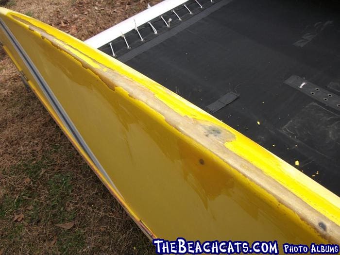

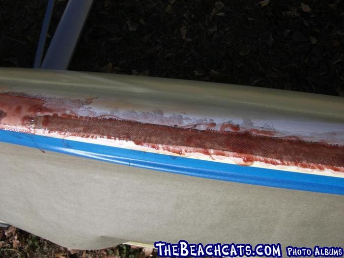

this is what i was working with...paper thin at spots, holes at the other spots...rock hard now!

My keels still look good from the outside. If you don't look through the ports you would never guess the gelcoat was thin. I see now why you added glass mat. I would too in that case. Funny thing, the thin gelcoat lets you see the glass mat pretty well. Looks good so I will stick to building up the bottom 1". I figure it might take two of the small kits this time and one every 1-2 years thereafter.
