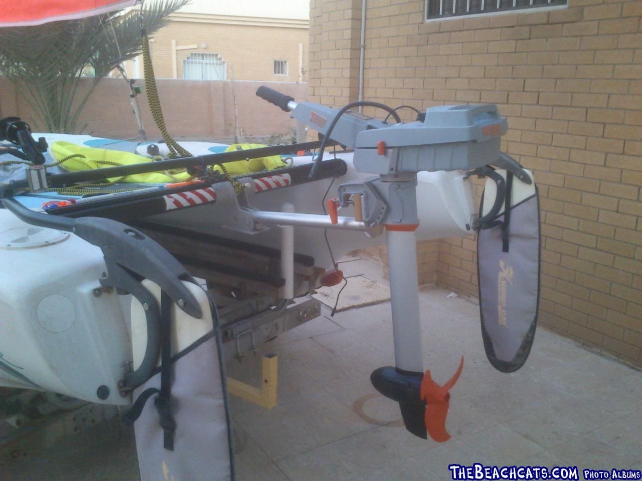

$500 for mount if quality is well worth it. Sure you can fabricate a mount but sometimes its worth having a fixture which well just works as it should.
i have seen mounts rigged with plywood and bungee and in one case the motor kept shifting.

If you are a marine fabricator, or close, and have the facilities to fabricate your own gear, that's awesome. Go for it. Most don't and most home-made plywood/pvc solutions are not "marine grade" and will likely fail at the worst possible time....
Torqueedos are a fantastic marine motor. I think some are totally waterproof and use the lightweight batteries ... if you have unlimited funds, that is far and away the best choice.

This is what we did for the Catalina trip,cheap and cheerful but pretty strong.I used an epoxy coated 2x6 laid across the rear and held on with modified J bolts.We used a 2 1/2 hp 4 stroke motor.I did um and ah about taking the motor but in the end it was the right decision as it took 4 hours to get over compared to 11 for the guys without a motor.Never any chance of capsize as there was very little wind.When we do this trip again in the summer we may decide not to take a motor as the winds are way more predictable.One of the highlights of the trip was seeing what we believe were blue whales breaching aft of us on the return trip!

Deluxe motor setup, Cheata mount and Torqeedo (this is a $2,000+ setup)
Cruise and Carry on custom mount (kind of thing you can do if you are a machinist)
