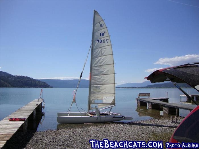

Hello I picked up a NACRA 18 Sq a few years ago.
What can I do to make her go faster?
Or should just get a newer bigger cat as I am 6' 2" 290 lbs, and the winds are pretty light around here.
http://www.flickr.com/photos/31840888@N08/6202014849/
I tried adding a jib I picked up but it turned out badly when it unfurled in its shore rack. Nuff said.
At the end of this year I found an Allum scaffolding tube and added a hooter(Heavy I know but the price was right untill I can find a cheap windsurfer mast). It seemed ok but I only got to try it once and I don't think I will be able to use in higher winds. I also added a 2:1 purchase to furl closed better.
I was also thinking about adding an outhaul, but I don't want to lower the boom any lower in doing so.
I was thinking about putting some sort off U slide on top of the boom with two bolts thru the boom which would slide along a cut out groove? Using internal sheaves for the purchase?
Oh I'm also working on a very tight budget.

Pretty much all around as there isn't alot of wind here on the Okanogan lake.You are already sailing the largest one-up beachcat out there! try adding a really flat cut assy spi or screacher.
And a new squaretop main maybe.
Would love a new or used square top but I think the price would be out of my comfort range.
I just put the jib I had, on as a screecher/hooter and while it did seem to give better pull in the one try with light wind. I'm not sure how much wind I will be able to use it in being such a hap hazard set up?
If you're sailing an original NACRA Square, it'll have a fairly bendy mast, and putting a headsail on it is a very bad idea. You will break that mast.
Glaser is the man for building mains for Squares.
You should have an outhaul on your boom already. Bit of track with a car on it. If you don't, then do like the more modern cats and just make a loop of HM line around the boom with bungee return and line-to-cleat out. No need to add weight and complexity. Actually I think I've got an extra boom somewhere but I really wanted to sell all my parts along with my Square.
The usual MO for stock NACRA Squares is to add another foot to the mast height (from 30' to 31' mast) at the top. I found a NACRA 5.5uni mast and did that to it, so now mine is a prebend mast. That said, I have a custom Ullman main for my Square.
As far as I know she is an original 18 SQ.
I don't intend on using the Hooter/screecher in any kind of heavy wind.
It is just that the winds here in the Okanagan are so light I feel I need more sail.
Would tightening the diamond wires help or upgrading the spreaders to the swept back kind? Save the mast from damage?

Tightening the diamonds should help, but then the main probably isn't cut for prebend. Swept-back spreaders are another typical upgrade, but then, you'll still need another main cut for the prebent mast. Frankly, your best investment would be in a new main and a decent boom from the sound of it.
HM stands for "high modulus" http://en.wikipedia.org/wiki/Ultra-high-molecular-weight_polyethylene ,and yes, Kevlar is one example
Is your main loose-footed? I've never seen a Sq w/o an outhaul.

Yes she is loose footed. Here is a closer pic of the boom area.
That HM line outhaul with a bungee return and cleat tension absolutely sounds like my best bet.
