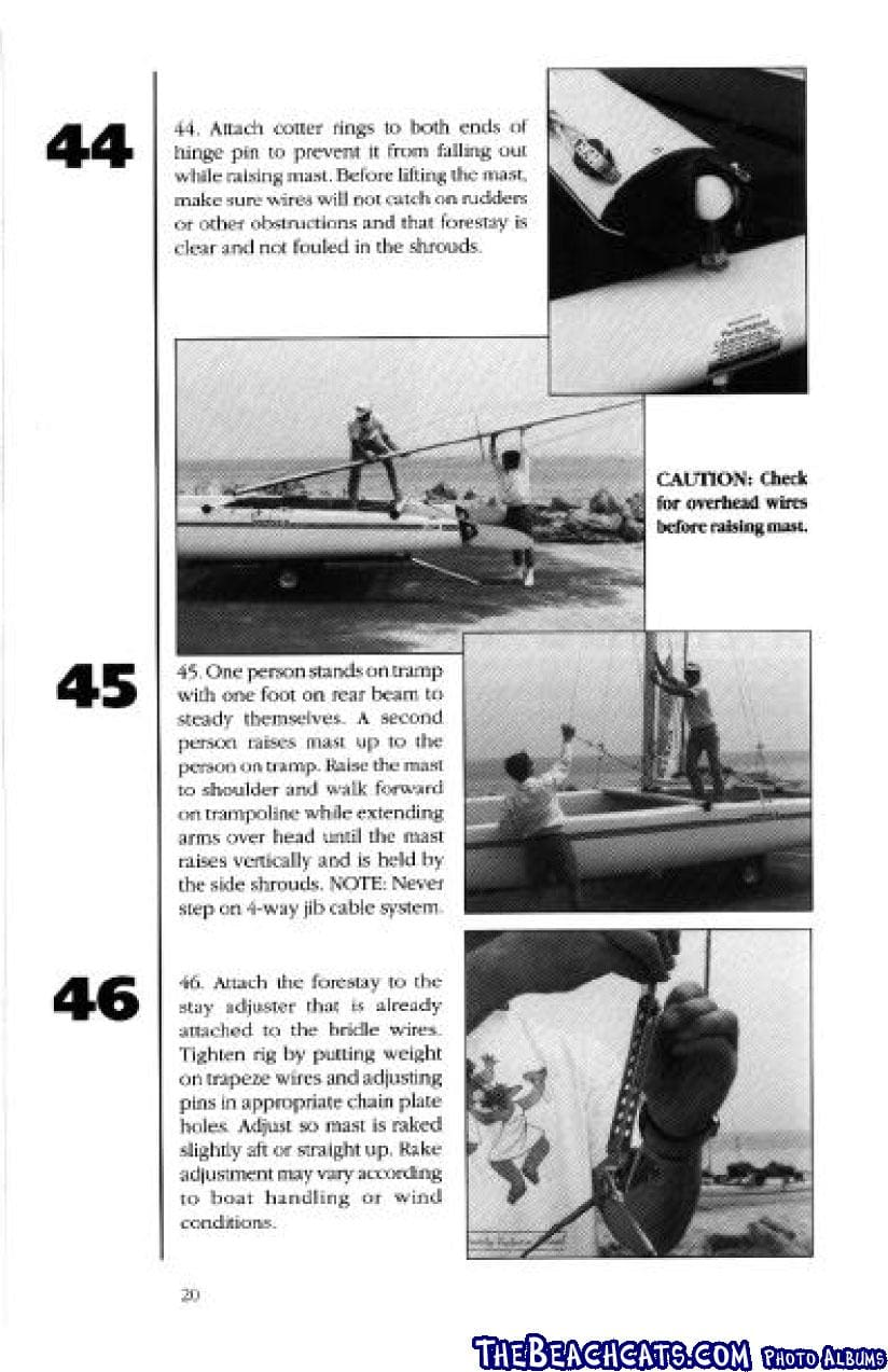

From the 5.2 manual
Click the photo to read.
Edited by skarr1 on May 19, 2011 - 01:16 PM.
