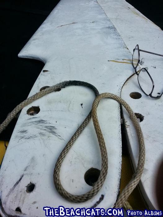

The rudders.............
Old:
Updated:
The castings really need some cleaning but that will be a winter project. I also found small plastic knobs on ebay for four bucks that will be used for the downhaul line. They are on their way.
Edited by peterk123 on Sep 06, 2013 - 06:18 PM.

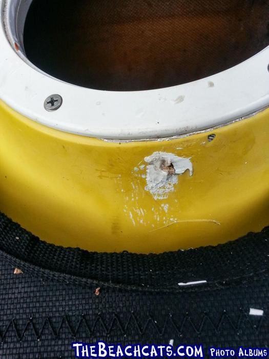

I pulled the plugs, and the rudder brackets, because the guy gooped a pound of silicone over the fittings. Ya, that was fun to take off. Anyway, imagine my surprise when I stuck my finger in there and felt a wall of dirt. Fifteen minutes with a hose cleaned the insides of the hulls quite nicely. So, here is what happens to pine needles after thirty years. Note to self, keep all portholes covers closed.....
I think I lightened the boat by ten pounds.
Posted : September 7, 2013 10:35 am

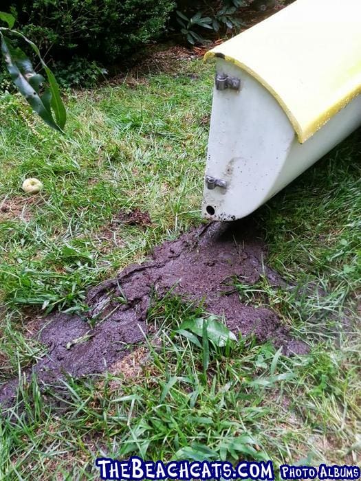

believe it or not, cats (and other animals) love to get into hulls without ports on them
I have an old set of ports that i drilled a 3" hole in added a 5" straight pvc pipe and topped that with a u shaped pvc tube so rain water couldn't get in. i covered the hole in the with bug screen.
rig up a screen or something if leaves are a problem but leave them open if you can, it will fight soft spots
Posted : September 8, 2013 12:10 am

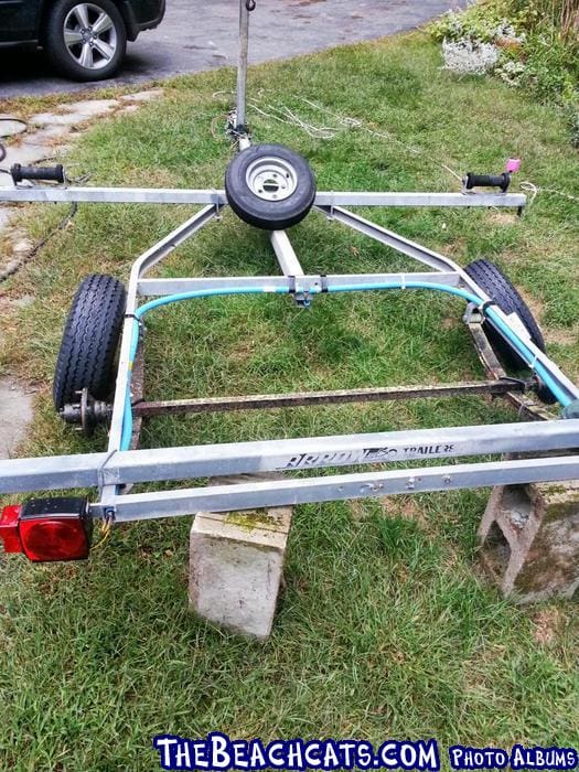

New lights, and wiring. New wheels. Pulled apart hubs, cleaned and repacked them. I soldered all the wire connections and used plastic flexible conduit to give the wires a little protection from the elements. I am so sick of trailer lights that don't work. Hopefully these steps help.
Posted : September 10, 2013 11:27 pm

peterk123 wrote: I am so sick of trailer lights that don't work. Hopefully these steps help.
I share your frustration.
What solved it for me was submersable LED tail and marker lights, soldering all possible connections with a piece of plastic straw on one side so that after it cooled I could slide the straw over the solder and fill it with silicone to keep the water out. I used hose as you did to protect the wires around the wheels and on the tongue connection.
Posted : September 11, 2013 11:13 am
