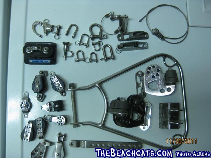

This photo was the original setup & does not have the lines rigged properly. It should be a continuous line, dead ended at one of the eyestraps, through the end of the rotator wishbone- back through fairlead- through cleat- across tramp to other side-through cleat-fairlead-out to wishbone end-back to eye strap & dead end.

Adam, on the boomless boats they are there to INDUCE rotation. Have a look at the final pages of the NAcra manual, (Damon has it here under Technical if you don't already have it).
You mast should freely rotate to where it should be most of the time. It naturally wants to put the leading edge into the wind, the most streamlined position. When going deep downwind, the wind will be from behind you. I think the idea is to rotate the mast further around, to obtain a smoother flow.
Edchris, Do you have pictures of your new setup?
That photo is how it is, except run a single line as described. You also need a small bungee, or line, from the end of the wishbone up to an eyestrap on the mast. Otherwise the wishbone tends to fall down. If you want to try it, I have a spare rotator, & I think I have a couple of the curved mounts/cam/fairleads that you see in the photo of my 5.7. The rotator is the one pictured here.

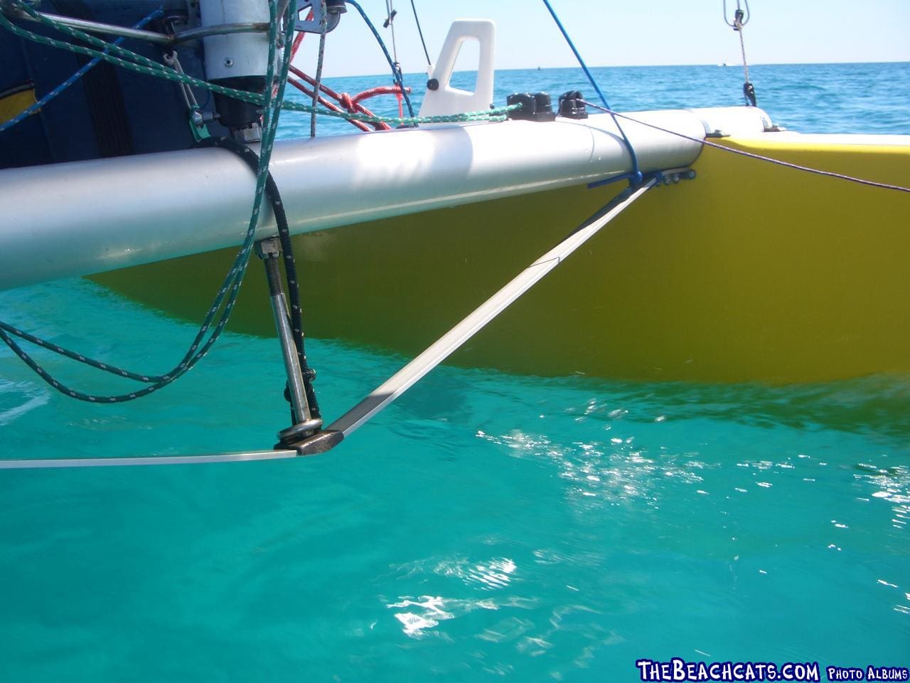

Here is a 6.0 using it. Note he does not have the lines run in this photo, it rigs the same as I described above.

Here is a picture with the factory harken hardware.
