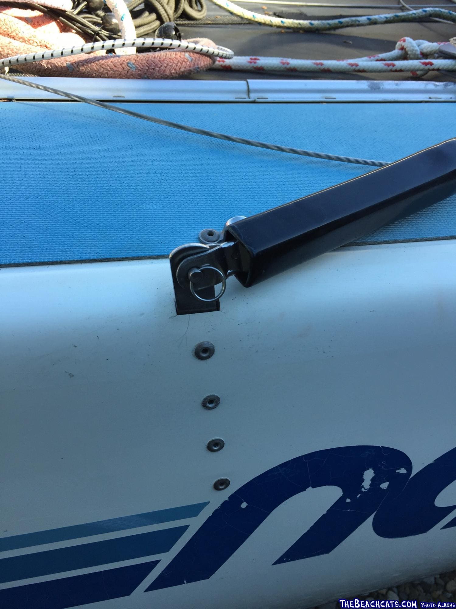

Issue 1: There are cracks where the shroud chainplates enter the hulls. On the starboard side, there was clearly a fiberglass repair done, outside and probably inside. There is only one inspection port installed, on the starboard hull just inside of the shroud chainplate, likely to facilitate repair. About a 2-foot square section on the side of hull was refinished, though the added gelcoat (or maybe hardened marine paint) is flaking in places. On the inside it looks like a lot of epoxy was added; can’t really tell how much glass fabric was used. On the port hull a series of rivets were added on the outside of the hull to reinforce the port shroud chainplate, presumably to avoid a repeat of whatever happened on the other hull; there is no inspection ports on the port hull.

1) Cracks and repair of shroud chainplates
This is normal, especially cracking of gel coat near the top of the fixture. They do fill and repair, and probably don't mean a structural failure, but rather normal flex in an area that gets a lot of stress.

1. If it was repaired it looks good. The rivets are supposed to be there. A little cracking where the chainplate exits is normal make sure you seal that up its a good place for leaks to happen.

The repair job they did on that chain plate is the sh*^ts, makes me want to puke. There appears to be no cloth, only resin, that means no strength.
I would grind it out,(if you remove the hatch casing you can put a 4"angle grinder in), & replace with 4-6 layers of wetted 6 oz cloth. You should use just enough resin to wet the cloth, & it should be clearly visible through the resin.
I'm not sure why there are no rivets in one chain plate, perhaps they snapped it & replaced it with a homade fitting?

Your model was built just before they went to the "staps". Remove an end cap, the beam is either held by a half moon shaped chock, or two studs. Either way, softness in the white, just ahead/aft is serious.
