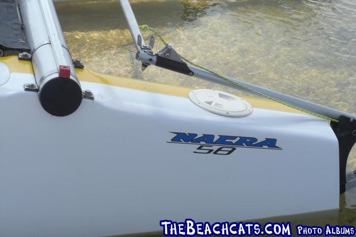

Philip, just out of curiosity, what is the upwards pointing U-bracket on your tiller tie bar for?
Posted : August 25, 2010 4:45 am
(@skarr1)
Posts: 414
That U-bracket is the old cross bar connector, now re-purposed as a hiking stick holder. I have them on my boat also, they work great.
The bolt used to go through the tiller arm and the U part was on the cross bar. If you twisted the bar some how the pivot point would not be horizontal and you could not turn. Murrays has the up grade part. The bolt on the old connector replaces one of the pins on the new connector.
Philip told me about this, I did not think it up my self. I don't know if Philip did.
http://www.murrays.com/mm5/merchant.mvc?Screen=PROD&Store_Code=MS&Product_Code=56-5516&Category_Code=
edited by: skarr1, Aug 25, 2010 - 06:36 PM
Posted : August 25, 2010 1:24 pm
(@pm)
Posts: 3376
Edchris177 wrote: Philip, just out of curiosity, what is the upwards pointing U-bracket on your tiller tie bar for?
skarr1 wrote: . . . now re-purposed as a hiking stick holder. . .
BINGO!
As for the tie bar end upgrade, an absolute must. Don't bitch about the cost. It is the SECOND most dramatic and improved upgrade you can do to the Nacra, especially all that is connected aft of the transoms. Mine actually had a Prindle logo embossed on it. Wonder if others do ??
Posted : August 25, 2010 2:29 pm
(@erice)
Posts: 1419
or for a $1 of stainless lockwire you can "tie" the 2 parts of the old system together to prevent the rotation and binding
Posted : August 25, 2010 2:37 pm

(@skarr1)
Posts: 414
The first upgrade is to read
Posted : August 25, 2010 3:09 pm
Thanks. I was going to order that part, as my cat was crap for tiller to tie bar when I got it. It turned out that was the only part from Murrays that I needed, & shipping to Canada is $30, so I made new brackets from 304 SS.
I know what you mean about about the U-joint locking up if in the wrong position. I took a tip from ERICE, & fixed mine with some aircraft SS lockwire, problem solved.
Do you use the holder when "parked", or other times when it is not extended?
I leave mine on the far side of the tramp when on the lift, or at my dock, to try & avoid having someone step on it. If the tiller is extended, it drags in the water when I turn, so sometimes when soloing in hairy conditions, (20 kts tonight)I just toss it straight back & use the tie bar to steer through the tacks, then pick it up again as I get things sorted out.
Posted : August 25, 2010 3:20 pm
(@skarr1)
Posts: 414
I use mine any time I want the hiking stick to stay put. Comes in handy when on the wire to set it down and straighten out the main sheet. When collapsed on the beach it keeps the stick in a protected location.
