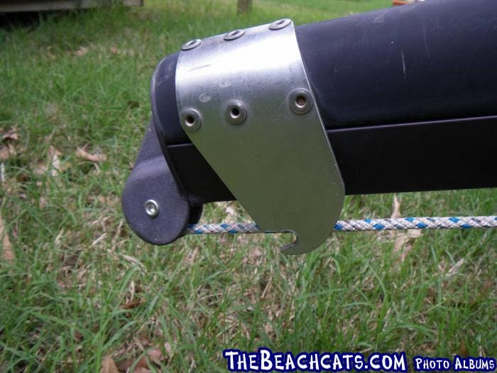

Does the top of your mast look like this? (my h18)
My pully is part of a casting that goes down into the comptip. Looking at the Hobie Parts diagrams, it looks like it's Hobie part # 60602041, not sure how it's attached, probably uses common rivets with the hook which is a seperate part # 61610101

wow Damon ... thats one heck of a hook Assembly you have there... my H18 didn't have a wrap around collar
