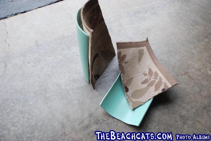

Cradles in the making: Oven heated water pipe and pressed on hulls to cool. Thinking now of bracket arrangement.
