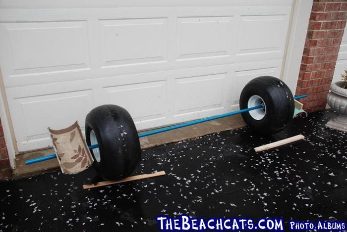

I finished up my Loser Beech Wheels today. I'm confident they'll hold the boat over bumps but testing in actual conditions will be the final test. They'll fit real well on the trailer too. Not happy about the carpet pattern but my wife bought a new one... so this one got cut up. I'll post a pic of the wheels in action when I get to the water which is coming up soon.
