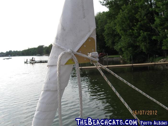

We use a UV strip on both the 5.7 & 5.0. It is sewn onto the jib, full length of leech & foot. It only goes on 1 side, doesn't matter which, just wind the furling drum so it ends up on the outside. Has been on the 5.7 for 3 years now.
Both boats are left fully rigged, including blocks, all season, except for the main. Jib is dacron, & hasn't grow any mildew.
I just fully furl, wrap the furling line twice around the mast & tie, then tie a safety line. wrapping the main line prevents it from ever coming out of the cleat. The safety line stays on the jib clew, it will just trail when sailing, & you don't have to look for it when putting the boat to bed.
UV strip is about 10" wide, I can measure it for you next week...just heading out to Vegas for 5 days, going to do a road trip around Death Valley.
As you can see, the strip can be quite narrow near the foot. however as you go higher, more of the jib is exposed, requiring a wider strip. I think the sail loft just used the same width all the way as it was easier to cut/sew.
