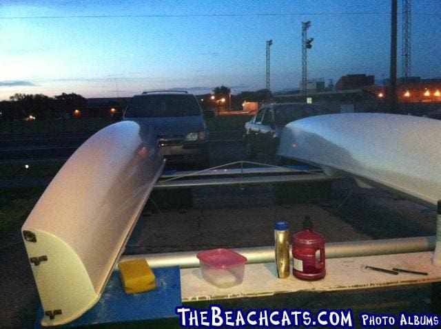

After 4 coats of Red Max. No polishing.

They look great, Quarath! I, too, did the hulls on my H18 and was *very* impressed with the results. I couldn't find the Red Max so I used the "Zep Wet Look Floor Finish" alternative I mentioned above. I don't have any pictures to share, but my hulls turned out like yours'. Well, with one exception - I didn't bother with my blue decks because they're terribly faded and I couldn't manage to get a uniform color. How did you apply the Red Max? I used the "Poliglow" method and wrapped a chamois cloth around a block of wood. I then squirted the Zep onto the chamois using an empty Dawn dish soap bottle. Sure beats waxing, eh? Thanks again, Zach! That Barkeeper's Friend is gold as well.

Yes used small padded applicator used for waxes and just dipped it and wiped it on very lightly in one direction being careful not to leave bubbles. the 4 coats went relatively quickly. I have not done any work on my decks yet only the hulls.
My color is not great after the bottom job I applied white gel coat. I really didn't even try to mix it to color match though after I found some info where someone used a tiny bit of sienna to make white gel coat match but by then i was done. Most looks ok. I had a hard time keeping it think everywhere I wanted.
I started with spraying it with Preval. It I thinned as much as I dared with acetone and it was ok but not great. It was good for transoms where I just masked off hardware. It was too much and way to slow for the bottom job I ended up rolling it on. Don't do it when you running out of light like I did because then you just have to sand and add more. I still have some spots I am not thrilled with on the gel coat but the glass work for minor repairs and bottoms went great I am thrilled to know the hulls are sound for may years to come.
