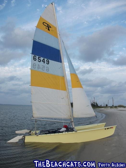

(@coastrat)
Posts: 1292
oohhh...pds624...can't help with the p-18-2, only helpful to p-16 sailors right now. here is a shot of my p-16, note reefing points by tel tale. there is 2 bullets on wire part of halyard that catch on upper mast. i shoot some sillicone lube spray in the mast groove every now and then and the sail glides up and down like a dream.
