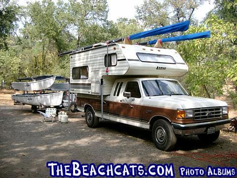

Some where I have seen a photo of a 30 foot mast on top of a Mini Cooper but this is the best I could find. You can also carry a mast on a cat trailer with out the cat.
