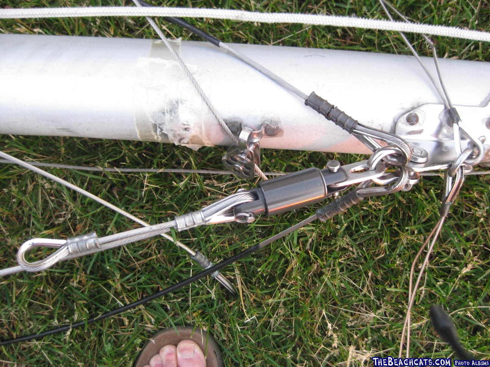

I assume you have a way figured to attach the the trap lines up near the mast hound? Many boats use a hound with double attach points, one for the forestay/shrouds, & another, slightly higher for the trap lines. This photo is from my Nacra 5.7. The trap lines are the upper wires. It uses 2 wires each side as it has double traps. (Clicking on many photos in posts will enlarge them to full size)

The reason why the trap wires are attached higher is to allow you to move forward and aft the side stay while out on the trap, but it will still work if attached at the same point, if you find room.
