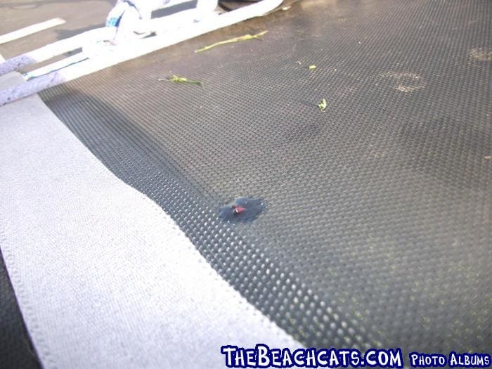

was to lazy to sew up this 1/8" hole in my mesh tramp proper, mixed up some west system epoxy and did the ole panty hose repair. the epoxy dried up and seems to have worked ok...wondering if someone else has tried this. just want one more season(or three) out of the tramp...i know i should have sewed it! but this was all i was in the mood for. 😉

The epoxy, unless you used G/Flex, will:
1. crack, since it's more stiff than the surrounding flexible mesh, and the edges will catch on people and things and be a PITA;
2. yellow and get even more brittle, unless you added a UV stabiliser of some sort, and once yellowed (if not before), refer to 1.
G/Flex is, well, flexible and might have worked. Did you do this on the underside of the tramp, perchance?

the hole is next to the tramp pocket and the repair is dime size...i rubbed in the epoxy so there is no "blob", it's more like a stain on a shirt. the repair is flexable even after it cured and is real strong. might top it with g-flex for u/v protection or just sew in a small patch later...needed to step the mast sunday and didn't want to risk a tear.

Well, as a canvasworker, I always wince when people do things like glue up sail repairs etc. Because they generally then later on bring them to me expecting that I can sew through the goo or will be willing to spend the time to remove the goo...

there's no restoring this ole tramp(easy golfdad75)...when she goes, she's gone! it's amazing how strong the fabric is, guess the stitching is what goes first.
