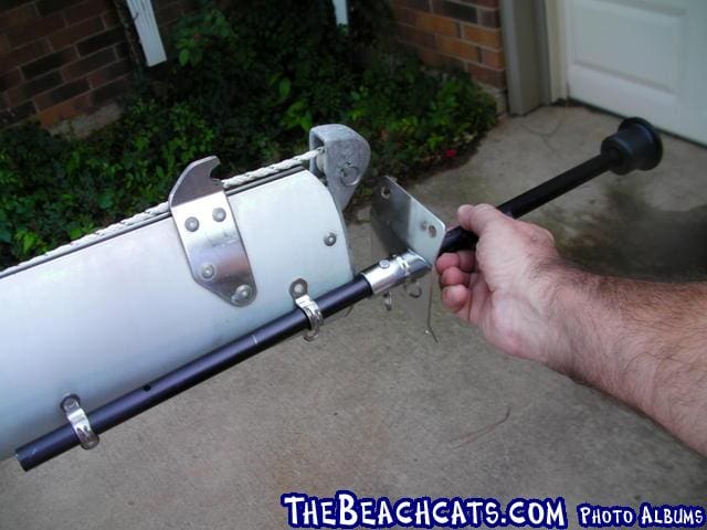

Peter knapp
(@pknapp66)
Posts: 687
Here is a pic of a conventional mast hook.
Posted : October 6, 2012 1:57 am
