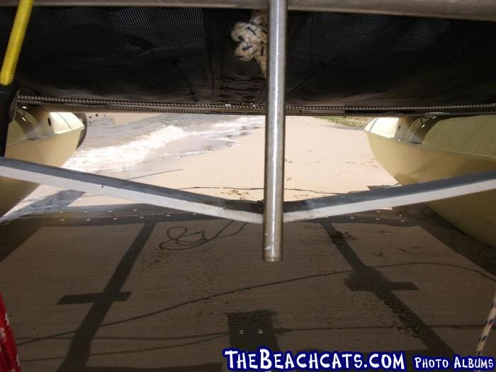

was sailing in some nice winds this weekend and heard the dreaded bam...my first instinct was to look up at the mast(now) after loseing the mast a few years ago but she was still standing. turned her around and headed to the beach nice and easy and found this...
i adjusted the striker rod a bit too tight when i recently replaced rivets on the mast base...manual says 1/4" play up and down, i'll go with that next time!

Yeouch! Glad you had the presence of mind to turn back to shore before you lost anything more than the dolphin striker!
Posted : June 19, 2012 5:18 pm
Posts: 2531
Good thing you didn't loose the mast. Make sure you measure the length from one end of the V brace bar to the other. Measure while it is still attached to the beam...you want the length from where the outer end bolts on to the other side.
I have 5 of those braces, & they are all different. If you don't get one the same length, you may not have enough room on the DS rod, or you will find that you have to force things to get the bolt holes to line up.
Pete sounds like he has your fix, if not send me a PM, I probably have the correct size.
Did you loose the pad that the DS rod sits on, or is it just not in the photo? I have a couple extras if you need one.

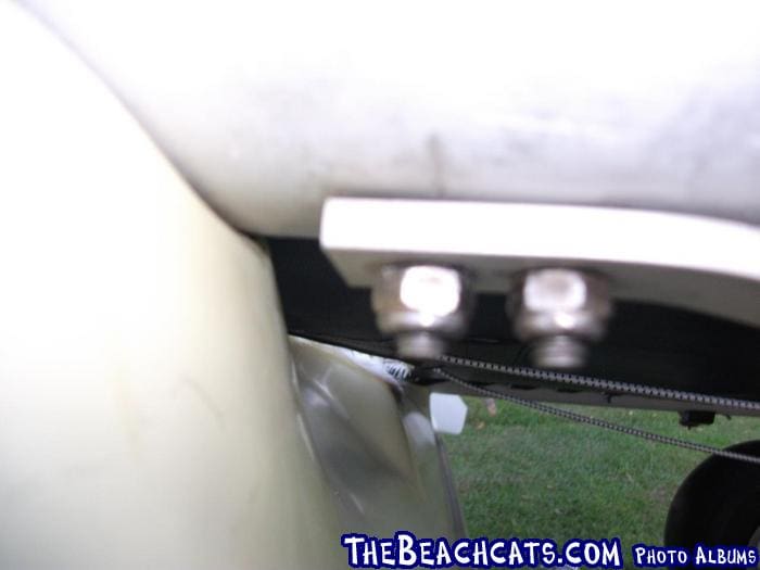

was replacing the parts today and noticed this little beauty on the bottom of the crossbar where the d/s strap broke...it's a little blurry this close up but you can see the crack coming off the left hand bolt. i'm not sure how long we could have sailed before the bar just sheared off, but i don't intend to!

nacra did have some failures there and i think i sleeve used to be available that would go inside to spread the loads
maybe worth contacting nacra dealers to see if they have any sleeves or spare beams
Check inside the beam for the bolt plate. Both 5.2s we had were missing that part. It goes inside the beam.
The bolt goes through it, spreading the load over a larger area of the beam material.
The Nacra part is not quite the same, the difference is that yours uses a 2 hole piece, the Nacra is longer, 3 holes, to reflect the V strap with 3 holes/bolts.
It is simply a strip of SS with the appropriate holes drilled to accept the bolts. Your current bolts appear to protrude 1/8" or more, they will be long enough.
If you cannot source or make the part, use large SS washers. Hold them with vice grips over a 2" OD steel pipe, & peen them with a hammer. The slight bend you put in them will pretty much match the ID of the beam, & once you do them up they will conform the remaining bit.

after further review...the other side of the crossbar is cracked in the same place. looking at the owners manual it says the number one maintanace inspection is checking the d/s rod tension and looking for said cracks through the bolt holes. i'm not sure the cracks were not there before the brace snapped but i believe that loud bang noise included it. my new d/s rod didn't have the ss screw on the bottom to keep the rod from loosening up prompting me to over tighten it so it wouldn't come loose...again. when i get the new brace and stuff on i'm going to drill/tap for one. you never stop paying for your education...
Posted : July 11, 2012 3:25 pm
Posts: 2531
I personally would not bother with drilling & tapping. That was done with the old style, thinner rods. The Nacras came with the 9/16" rod, & they do not use the screw through the bottom.
I would spend a couple bucks more, & use aircraft lock nuts for the DS Rod. Once those are snugged down against the beam, with appropriate washer in between, it is very unlikely they will come loose. I have never seen mine loosen up in 3 years of bashing the BeJeezes out of it.
