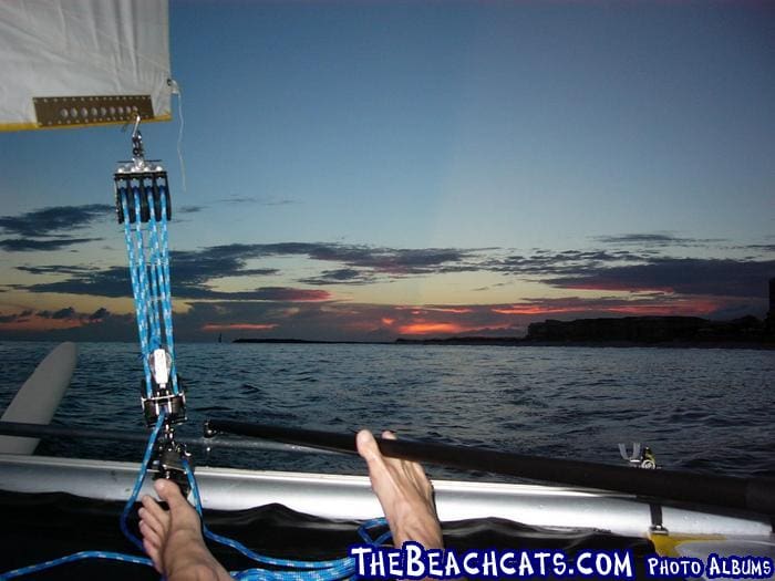

I found a some old pics in my album
Autopilot- HAHAHAHaha awesome!

The pic titled "crystal clear water", what is the line that is shackled to the bottom of the DS rod? I can't quite make out if it ends at the mast, or goes into the tramp pocket. Is it some sort of mast safety line, or the righting line?
Thanks.
Thanks.
That is a rarely used righting line, just there for looks. 😉
