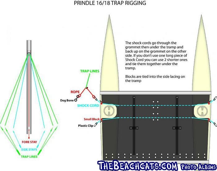

From Murrays http://www.murrays.com/index.htm
Does this help?
Posted : May 1, 2010 9:24 am
(@skarr1)
Posts: 414
At the top the line runs up to your mast hound. Your harness hooks to the ring on the left. The shock cord on the lower right goes to the same trap wire on the other side of the boat Usually under the tramp from one side to the other. There are several other types of rings and hooks that you can use.

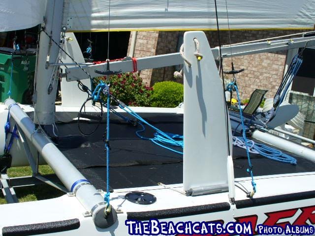

Here is a picture from I believe, Airbornes setup. The trap wire comes from the masthound down to the trap handle. Below the handle is a short line (blue) that runs through a small block. One end of the line is connected to a metal loop, the other end to a bungee cord that runs through the front beam, to the trap line on the other side,or under the tramp to the opposite side.
The bungee keeps the line retracted & snug when not in use. To use, grab the metal loop,(dogbone) & hook it under the metal hook on the harness you are wearing,(see picture of harness above). As you hike out over the side, the blue line will run through the block til it hits that little black rubber thingy that is tied onto the blue line. This will limit how far you can "fall" towards the horizontal. Moving the little stopper serves as an adjustment.
