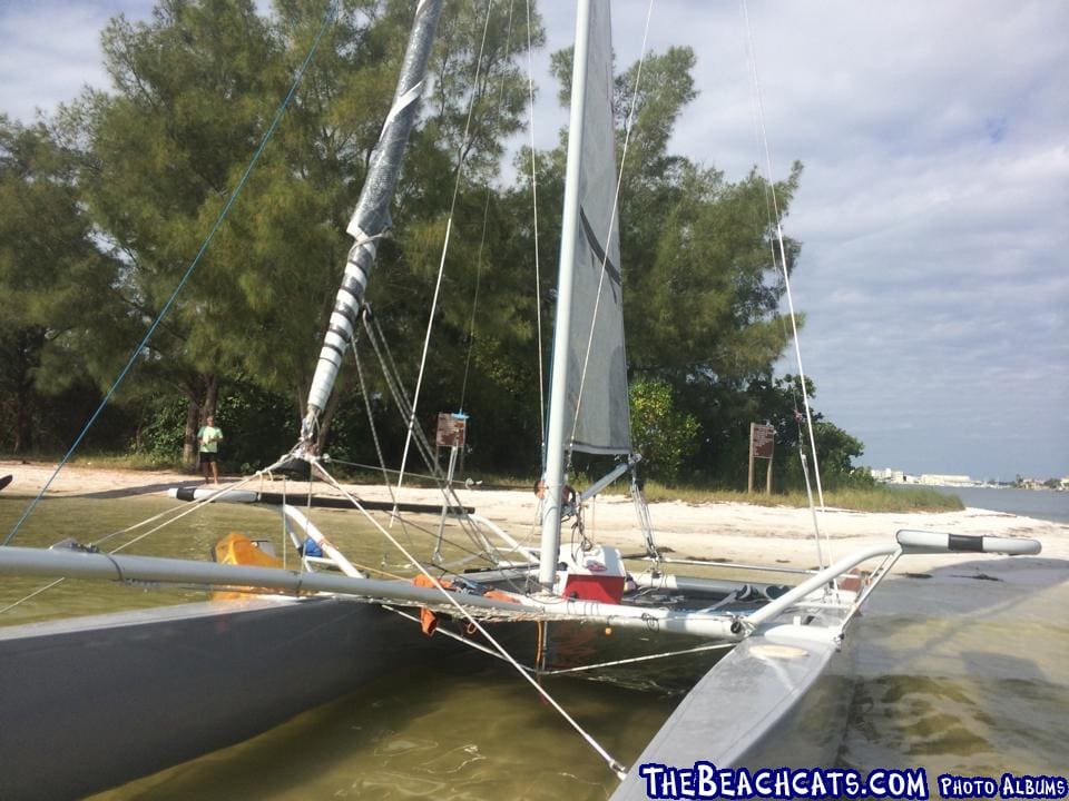

dakjones1 wrote: with a partial front tramp hooked in triangles from the front wires at the pontoons
Catamaran's have hulls, pontoon boats have pontoons 🙂
for my 5.5 - I ordered a rectangle front tramp from Sunrise yacht company - http://multihullnets.com/
it is perfect - has a pouch on top for my anchor and on the other side (underneath) has a pocket for my righting bag
it sits right in front of the beam and is tied to the beam and 1 eyestrap on each hull
my 6.0 has a web triangle that goes from beams to furler. it is perfect for my anchor and maybe a dry bag.
it has no weight nor windage

Thanks for all the input. Going back to look at it on youtube and found out it was a 5.0. You can see it if you search Nacra pine view and see it on the video. Understand on the weight and putting to much weight forward. Just looking for space forward of the mast to put some things. Thanks for the pics on how you got it set up on the other cats which gives me some options. Do you guys have a line on wings for the 5.7?
