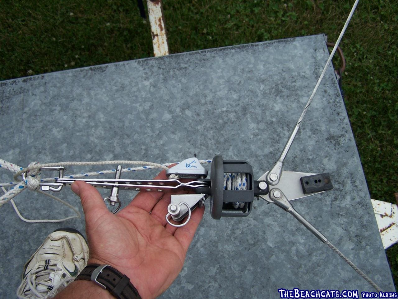

Thanks Nacra, as part of my spring build up I'm going to install all the parts I bought last year! I was thinking of a cleat like the ones on the mast that cleat the downhaul. Do you run the line from that cleat directly to the drum? Does it get in the way of dealing with the jib? As you unfurl the jib, you wind the line onto the drum, correct? I'm thinking that while sailing, you only have a few feet left over, could it not just dangle?

You really want a cam cleat instead of the jam cleats you have on your mast. Those will give you fits because they like to self cleat at bad times. Check out my setup here: http://www.thebeachcats.com/pictures/?g2_itemId=74481 Just a straight run from the front beam to the drum. It runs instide and under the jib sheets and I have never had them interfere.

Ed, have to leave shortly so I am going to try and get a pic up while you're still online. The picture of my roller furling setup is one I use on both the 5.0 and 5.7. The plate the bridal wires and furler attach to I made from 5/32 stainless plate. It is a sanitary way to also mount a TeloCat wind indicator between the bridal wires. I use a 3/32 cable for raising the jib with a shackle on one end and a swagged eye on the other. Notice on the v-cleat there is a 2' line for tightening the jib. I use a 1/8 line tied thru the eye which is pulled thru the zippered luff. This line is then untied and stored in the tramp bag. The 2' line is fed thru the eye, pulled down into the v-cleat wrapped a couple times and tied off to secure it. As you know the NACRAS like a tight rig. Shrouds are adjusted for the proper rake for neutral helm. Then while stepping the mast the forestay is pinned as far down the chainplate as possible. You do not want the line supporting the jib to replace the forestay as the wire in the jib of the Hobie 16's do. During the season while it is calm, I will raise the sail and sheet in tight. Then raise the jib and tension it just enough to take out the wrinkles, mark that spot on the line for reference when I have to raise the jib in a breeze. It may eem a bit complicated at first, but is actually simple to use. Hope it helps. Also Wolfman, Many prayers are with the people suffering along the Mississippi...
Thanks much. When I drove through Carpenteria last fall I picked up a Telo Cat, & was wondering about the best way to attach it. I've seen some drums with shackles, & whatnot to get the bridals attached to the bottom of the drum. You way seem pretty simple. Thanks for the photos.
