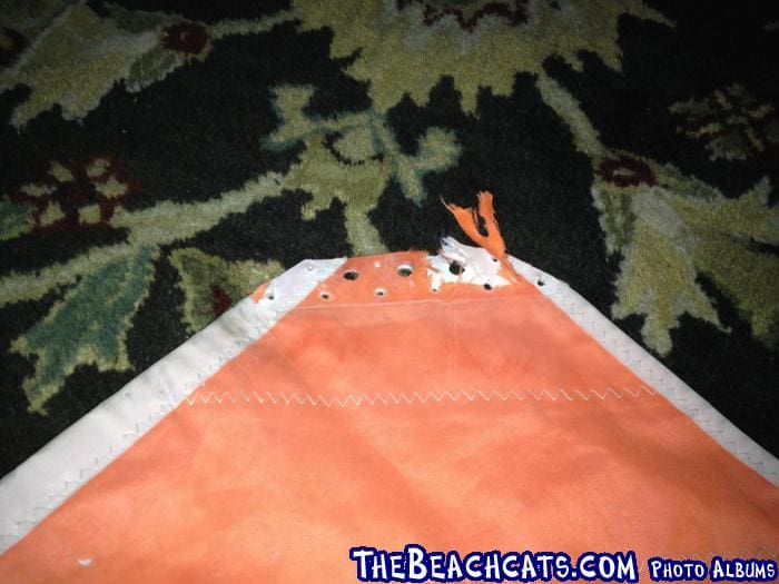

We were sailing in the sierra mountains this weekend and had very strong winds while some rain swept in. We were having a great time until the clew plates ripped from our jib. On the lake we just rolled up the jib and then sailed with just the main for a while before bringing it home. Now it is time to assess the damage and figure out what it takes to put it back together again.
I've checked Murray's and a new set of plates and rivets is pretty cheap so I'm going to do that. Before I hit buy on the order though, I'm wondering if anyone has any suggestions for how to reinforce the sail before I put the plates on and anything else I should put in the order.

Andrew, I'm not sure it was his sail that let go. Looking closely at the photo, only one hole is torn out, that would be where the blocks were attached. The rivets did not pull through the material. It looks like the rivets let go, leaving the jibs full load on the single hole where the blocks attached.
A brand new sail cannot take that load on a single point, so it rips through.
In a strong wind the clew plate stays straight, but it doesn't want to, it wants to conform to the bend in the sail. The rivets are then required to hold a tension load, trying to separate the two halves of the clew plate. A rivet normally is designed to mostly hold a shear load. Centre peened usually fail from the rear side when exposed to tension, looking at them you can see how little material is on the back side.
I had the same thing happen on an N5.7 mainsail. They used centre peened rivets, & the rear of the rivets were corroded from salt/age. The sail itself had seen fairly light use.
I heard the rivets letting go, as soon as that happened the hook on the main tore through the material.
In my case both plates fell on the tramp & were saved.
If you elect to fix it, think about the science behind a clew plate. Holding the forces without tearing through is not simply a function of using 10 rivets to spread the load, that will not last. The strength comes from the 2 halves of the plate squeezing the material tightly, in essence spreading the load over a distance equal to the top edge of the plate. Use vice grips, two strips of hardwood & screw clamps, or some similar setup to hold the plates tightly together BEFORE you start pounding the rivets.
Try not to hit the rivet 50 times, that tends to harden the rivet, making it brittle. Aviation rivets ideally only get hit 6 times to compress (and slightly expand the shaft) along with peening the end. The tin bashers in the hangar use pneumatic guns that give 6 hits to trigger pull. IF the rivet isn't "right", they don't hit it again, it gets drilled out & replaced. I also know that the rivets have shelf life, I've seen them baking them in an oven before use.

I looked at the plates when I got home tonight, it is definitely the rivets that failed. There is a good deal of corrosion on the plates, and all the rivets that are left are missing their backside. The sail itself has 2 tears, one from the jib sheet block and one rivet hole, the rest of the holes are intact.
I'm thinking some sail tape, new clew plate and rivets then hopefully that gets me a couple more trips to the lake this summer/fall and then maybe new sails for Christmas.
Thanks for the advise and I'm off to Murray's.

You should get a couple more years out of it. Just make sure things are tightly clamped together when you rivet.
Setting rivets is not hard, but there is science behind it. To bad ERICE isn't your neighbour, he has probably drawn more rivet on Boeings than anyone on this forum.
You need an anvil on the front side, not a 100lb blacksmith anvil,(though that will work), but a piece of solid steel against which you set the rivet head. This is critical. It prevents movement or absorption of energy,the rivet shank is forced to absorb the energy of the blow, & expands somewhat, making a very tight fit. The rest of the energy expands the end.
In the absence of a pneumatic rivet gun, you can use another small block of steel, or a chisel type tool with a concave, or flat head. (I have used a coarse pin punch) Set that against the back side & strike 6 good blows.
Research may show a duo, one holding the anvil against the rear, & calling "draw", "rivet".
What they are doing during "draw", is striking the material beside the rivet, to force it tightly together, then the call "rivet", is the actual peening of the rivet.
Centre peened, notice how little material was expanded on the backside, that is where they usually fail.
Make sure you get the right size rivets, both diameter & length. If you run into problems, go to your local aircraft repair operation, ask for an AME who does sheet metal.
