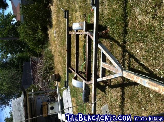

I have this old trailer and it has a busted lug stud in one hub.
I can't find a replacement stud with a square shank anywhere local. Any one have any ideas. i have been trolling online but have not found anything yet. I hate to replace hubs and or axle just for this.
Sorry not sure what the trailer pic rotated the thumbnail was right side up when I submitted it.

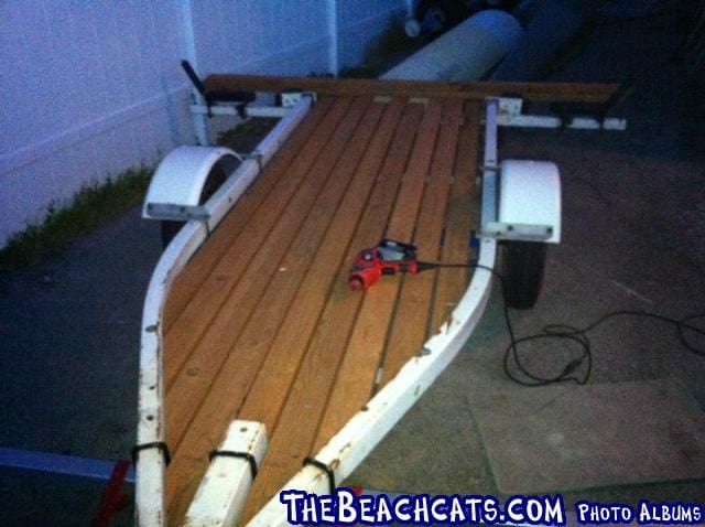

I tried to double stack a P16 on top of my P18 last weekend and the trailer couldn't handle it. (Not the trailer in picture). The springs were almost flat and the tires would rub and squeak on the fender at every little bump. I got about a half mile and had to go home and take the P16 off. I just had it upside down on top of the other boat with a 2x6 with padded ends between the beams.
This is the one I use for my P18. I just added the deck so I can put Camp Stove stuff under the boat.

The deck was really easy to do. You can get angle iron cross pieces at Home Depot/Lowes (I forget which I got it from) that are 48 inches for about $10. You need may 4 of em and only need to cut 1 down. They already have holes in them so if you get some good outdoor deck screws and put small washers around them you can attach it all from underneath. The crosspieces have a single bolt hold them on each side with a nylon grip nut. Deck is just pressure treated lumber from Lowes. I'll have to get an updated pic this one was taken while it was under construction. I filled in some of the wood in the very front with a layer on top so I could mount a big Rubbermaid. toolbox to it.
I am keeping an eye on it to see if the screws underneath are all holding ok. I don't want to be dropping them out all over the road. So far it seems ok but if I have trouble I may go back and take em out one at a time add a bit of glue to each. Will be a pain but better than flat tires.

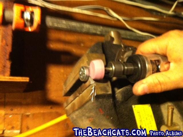

Update: I wanted to post this earlier but got busy sailing.
So I ended up buying a close match to length and thread at NAPA.
I then proceeded to fabricate what I needed from that
Turned out pretty good I think.
Fit pretty good to.
