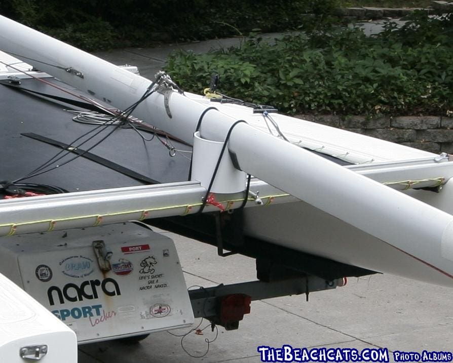

This is my DIY removable rear mast cradle:
http://www.thebeachcats.com/pictures?g2_itemId=112881

here's what i did. bought a short piece of PVC drain pipe from Lowe's or Home Depot, marked it with a pencil to match the shape of the rear crossbeam and cut the notches with a jigsaw. then i filed the edges smooth and added a piece of indoor-outdoor carpet under the mast. cost about $7.00. have to be careful when cutting. it slips over the traveler and keeps it in place right below the mast for travel. solid and secure.
