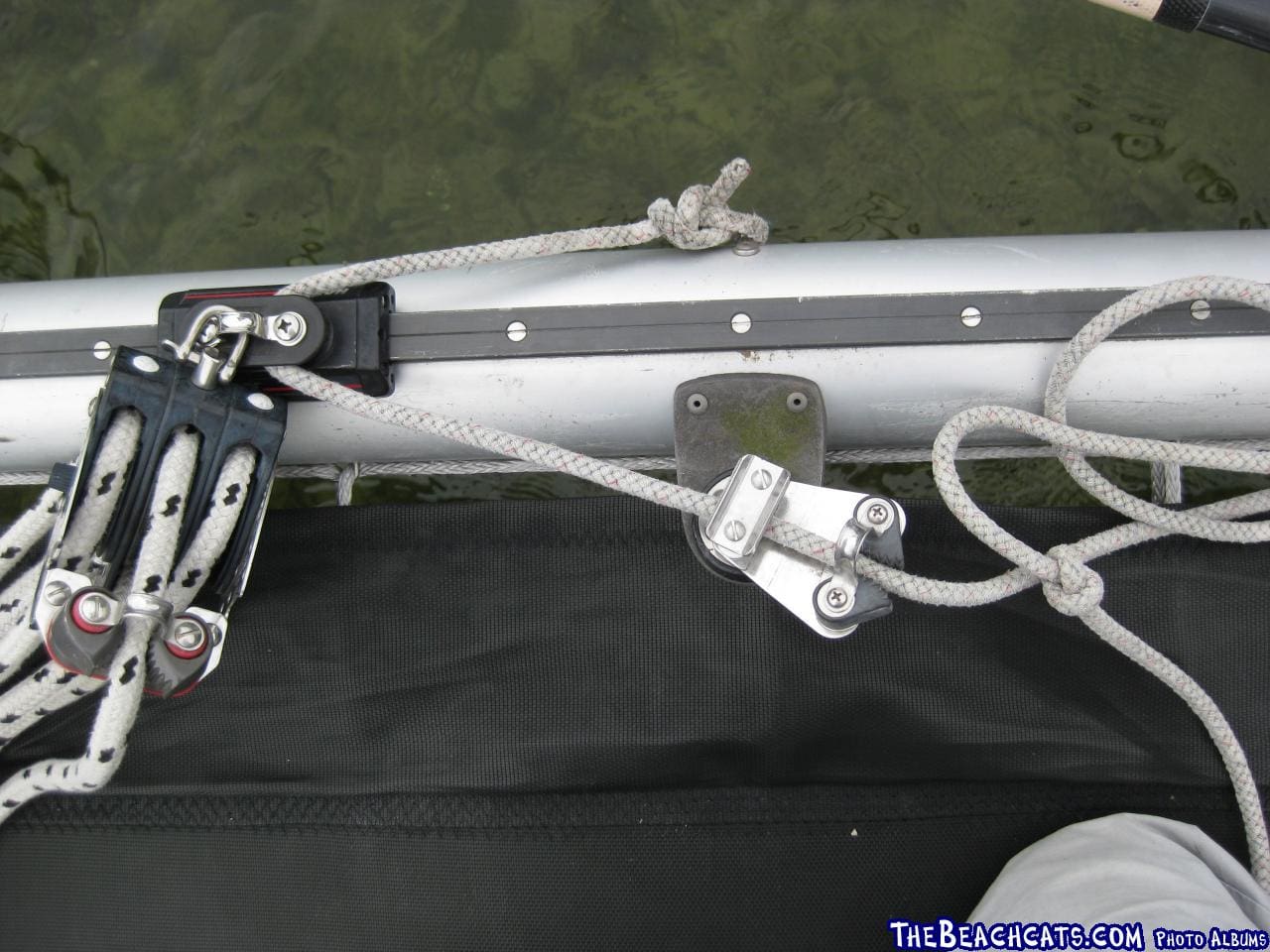

One more thing (isn't there always?)-my mainsheet is too thick to fit through traveler-fits through block coming off clew of main but I needed to further jury-rig another line just to control traveler...on my Hobie this is one continuous line I figured it's the same on 5.0
If so-what size/type line is recc for this boat? Do you recc Murray's or another dealer?

On my 5.0 I have separate lines on the traveler and main sheet mainly so I can remove and store the main sheet and blocks inside. When I head out sailing I just granny-knot the traveler and mainsheet lines together.

Make sure you have a knot in the traveler line that stops the car BEFORE it hits the end of the track. Otherwise it will sheer the stop off, the car will fly off the track, & all the bearings will go in the drink.
Knot the traveler line to the end of the mainsheet.
I think mine is 10' of 7/16"

the h16 seems to work well with 1 continuous line
the nacras seem to prefer a separate traveller sheet
