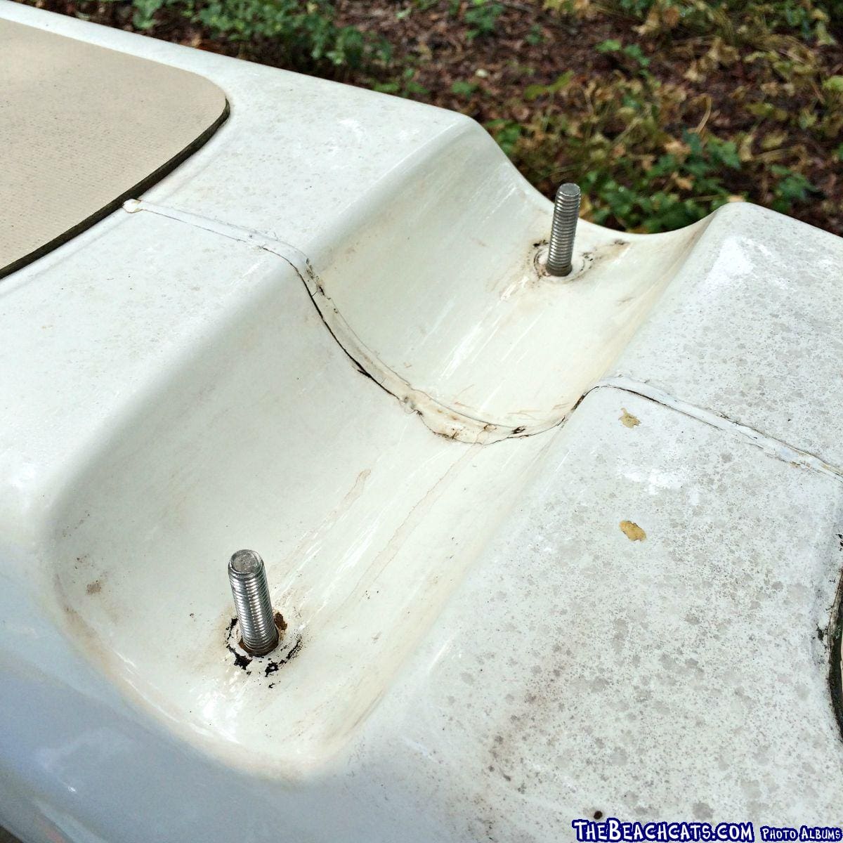

Looking over my crossbars/hulls and the attachment arrangement, I discovered something that makes absolutely no sense. My crossbars attach to the hull with two studs which stick up from the bottom of each crossbar craddle:
The through holes in the crossbar are larger in diameter than the studs. The outermost through hole is larger than the inner through hole:
When I noticed that the through holes were larger I thought well, they must have done that to make it easier to assemble and the hull alignment (as in parallel and square) wouldn't be an issue as when the tramp is tightened (with the nuts on these studs just snug) the studs will find the innermost position in the crossbar's through holes, both front and back, thus the boat will be in proper alignment.

So, with the centering type of crossbar casting on the rear crossbar and the non-centering on the front crossbar in theory the hulls would end up with toe in.
Can someone please explain, thoughts, ideas, how to align a Nacra? I only see one type of casting on Murrays which appears to be bossless. I'm going to race this boat locally and I fought for years to keep the hulls aligned on the Hobie 16's I've owned, constantly checking diagnals and tightening/loosening the tramp. From that I know first hand how much mis-aligned hulls can slow you down.

I'm not familiar with your "stud" setup, both mine just use regular chocks in the front beam only.
The holes in the beam are larger than the studs as it is not a precision fit, bigger holes allow for some tolerance in manufacture.
However, do your hulls have those little metal straps,(about 2-3" long), on the inside of the hull, just below where the beam sits?
Can't quite see far enough down in your photo.
If you have those tangs, then there should be a small fitting on the underside of the beam. Actually, it is the same "fork" that you hook the mainsail halyard into. When setting up the boat, those "forks" should be butted up against the metal strip on the hull.
Both Nacra manuals make reference to them. If yours is set up that way, that is what prevents the hulls from moving inwards.
IIRC your front width ends up appx 1/4" bigger than the rear,(measure from centre seam to centre seam).
When the rig & wind loads are applied, the bows will be pulled inwards, equaling the dimensions.

Edchris177 wrote: However, do your hulls have those little metal straps,(about 2-3" long), on the inside of the hull, just below where the beam sits?
I think this is what you're referring to:
My boat doesn't use that arrangement. It looks like this:
