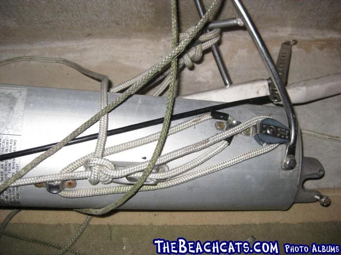

My 5.0 had the old style base. It was riveted on with three rivets. After drilling out the rivets, it just slide off. I put on the captive ball mast base, but it did not fit over the enter base. To seal the mast, I put styrofoam in the base and sealed it with silicon. Did anyone else run into this ? Did you leave the bottom open and seal everything above the base? Did the base of the mast change in later years to account for the new casting shape? Here are the old and new bases.
Posted : July 1, 2011 4:34 am
Posts: 4064
bh3700 wrote: Did the base of the mast change in later years to account for the new casting shape? Here are the old and new bases.
From your pictures it looks to me like they just eliminated the part of the mast base that covered the sail track, but the mast base still covers up and potentially seals the interior of the mast. That design could make it easier to install things like down-hauls that slide up into the track.

With the new base, there were two nice sized holes on each side of the sail track what would keep the mast from been sealed. I needed to seal those two holes. With the new base design, I was wondering if the base of the mast was supposed to be open for draining; however, with even a small chance of a turtling, I'll keep the base sealed as well.
Were these the holes you refer to? They are for mounting the mast rotation control arm. IIRC the bolt is 5/16", you should be able to go to the USA version of Canadian Tire & find two rubber grommets that will exactly fit that hole. They have a double flange, so they will pop in, the second flange will keep them from going all the way in. They will make an almost watertight seal, but can be popped out for drainage.

I ran into the large opening on the base of the mast too. I filled it with a load of silicone because it would have let a ton of water into the mast in a very short time as the unsealed space was probably 2 square inches! Anyway, my mast base did have 3 rivets holding it on. One in the front, another was the lower rivet on the cheek block and the third was the lower rivet on the main halyard jam cleat. I removed the cheek block, halyard jam cleat and, with the front rivet already sheared off, the base pulled out relatively easily. I cleaned it up, siliconed everything I could find then reinstalled and sealed everything. No problemo, about 2 hours of work. 24 hours to cure the silicone and I'll be sticking the mast in the pool to check for leaks. I'm definately going to look for a way to open a drain hole on the mast, just in case.

I see what bh3700 is saying, as Damon mentioned, the new style mast base has the piece that would have covered the base of the sail track removed, that would leave 2 small holes on either side of the sail track uncovered. Look closely at pic 1 with old base semi-removed, you can see the inside edge of the sail track, if you draw a straight line from either side of outside edge of mast circumference, it will leave 2 small triangles on either side of sail track uncovered, look at the foam plug inside the mast behind the base, makes a good indicator. Do as flyingfishguy did, seal holes.

I see what you were talking about now. The extrusion on that 5.0 is slightly different than my '84 5.7.
You can see from the photo that I do not have those 2 small triangles to deal with.
good call pointing that out, anyone else reading the thread may not have noticed those two spots. They would flood the mast in a minute or when turtled.

The first picture of the extrusion with the round bolt rope slot . . . I'm curious if that is an original extrusion from Prindle or someone else, or even Nacra. Nacra has been using the triangular shaped slot extrusion for a long time. Nacra outsourced their extrusions and stocked them in bulk, then built the mast to the order of the boat.
So I suspect that this might have been what the very early extrusion profile was with Nacra. Maybe some of you folks can check your older 5.0's and 5.2's.

I know my 1981 5.2 has the same extrusion as the 5.0 shown above. Had the same problem when I replaced my top casting. Did that same thing as you, removed 3 rivets put sealant on the casing, banged her in and re rivetted. Just filled the voids with sika 281 (similar to 3M 5200).

This is interesting and something we should document. It appears the new mast base casting matches (and seals) the new(er) mast extrusion but the old(er) extrusions end up with the two gaps.
Now we just need to nail down the model years and spell this all out for future mast base replacers.

I know this is an old thread, but I recently addressed the situation where the mast base casting leaves two small triangular gaps. I began by cleaning and roughing up the inside of the mast extrusion where the triangles are. I then built a dam out of duct tape and some blue play-doh I stole from my kids.
I then filled the area with West epoxy and flox.
After it dried I trimmed the excess with a saw, ground things the rest of the way with a grinder, and then finished up with 150 grit on a sanding block.
The final result seems much better than the giant boogers of silicone that were there before.
