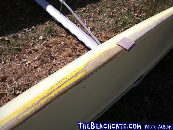

I just purchased my first catamaran, a Nacra 5.2, and took it out for the first time last weekend. Unfortunately I found out that the hulls leak a lot more than what the seller indicated. I thought he was a decent guy, and told me they leaked only "a few cups." Unfortunately its really more like gallons. When I put the boat on the trailer and cinched down the ratcheting straps, I could see that this caused water to leak out the bottom of the hulls right by the front crossbar. It seems that its coming from the seam where the two fiberglass pieces are molded together.
Today I took the hull off, turned it over, and sanded off the gelcoat on the bottom where the seam is. I filled a bit of water in the hulls and found a fine crack where water seems to seep out of. Its just right near the seam. I took several pictures of this, but it is difficult to see the water coming out. I can see on the inside of the hull that one of the previous owners has laid down some fiberglass on the inside of the hull where this crack is in order to fix it. Clearly that didn't do it.
I want to fix this, but I am not sure of what the right technique should be. Should I just try to fill in the crack with epoxy? Should I sand it down to be thinner and lay down some strips of glass on top and fair it with epoxy? Or should I completely cut this section out of the hull and try to lay down glass from the inside? The last option would be most difficult, as while there was an access port added where the damage is, there is also some extra glass and epoxy down there that makes a rough surface.
I've got some epoxy and microspheres on the way from uscomposites.
Here is a link to the pictures of what's going on:
http://www.flickr.com/photos/76489390@N06/7011488017/
I wish this forum gave us the ability to upload pictures.
I appreciate any advice.

Thanks for the advice halliske and dennis. Actually most of what you see was caused by me using my disc sander with an aggressive grade disc. I wanted to see what was actually going on with the fiberglass below.
Dennis, what I found actually was that someone had already done just what you suggested, which is why I found my boat has extra ports on the fore decks. And I'm the poor bugger that has to go in and fix it... what happened was that the glass they laid down did not bond to the hull completely on one side of the boat, leaving a less than watertight seal.
I just tried to break that glass away as best as I could, and I sawed a decent sized hole in the bottom. I'm laying down one layer of glass from the inside, but I'm then going to lay up another two sheets from the outside to bond to it. I tried to clean it up on the inside, but its tough to prepare a surface that has 30 years of crud on it, even after sanding and acetone. Hopefully that will give a better seal. I'll fair any rough edges with epoxy mixed with microballoons.
Its tough that the repair has to be right on the bottom edge though. I'll have to remove a fair amount of gelcoat to get my outisde glass to bond to the hull.

I already found out right where the boat leaked from, it was at the seam right near where the hull sits on the front trailer roller. Probably due to both wear and hull flex from too tight tiedown straps. Its in the same spot where a previous owner laid down some glass, but his repair didn't seal the hull 'cause it didn't bond the inside.
Well, I ended up laying down a single thin glass "wear strip" about 2 in wide right down the seam. Then I added epoxy with microspheres on top. It worked well on one hull, but the other one I let cure outside overnight and the dew totally screwed up the epoxy cure. It came out looking like orange rust dripping down the side of the boat. Time to get out the disc sander again. 🙁
For future reference, I think it would have worked equally well to try to seal the cracks with thin epoxy, and then later apply a thickened epoxy layer right down the midline of the boat as a wear strip. What I've got seems watertight now, but we'll see how well it holds up to mechanical flexing and such.

Well, first off I'm not anything near an expert on this. I haven't tried it out yet.
But I think that the microsphere epoxy mixture will likely wear down pretty quickly. After all, that's what its really designed to do-- to be easy to sand. So its probably bettter if it gets a layer of gelcoat or marine paint over it.
I heard Marine Tex wears well, but I already had epoxy and wanted to avoid buying another product. The microsphere mixture is really easy to apply. Its just like spreading icing on a cake.
I got the epoxy from www.uscomposites.com. It was $35 for a system with a quart of epoxy and its hardener. Way cheaper than the $60 for the equivalent West System from my local West Marine.
Also, I laid down a glass "wear strip" which serves the dual function of keeping the two molded halves of the nacra hull bonded together. I think other models of cats may be made differently and don't have the seam on the bottom. For better wear resistance I could have chosen kevlar, but I've heard that the epoxy doesn't sit as well in it. Also, I wanted to get the job done now and I didn't have time to wait for it.
I can say thought that this operation was much easier than I thought it would be. I tested the hulls by putting water in them and they seem to be watertight.
I haven't decided, but I think I'll coat the hulls either with Interlux brightsides or with gelcoat. I think I've got to redo the whole hulls. I'll have to brush either on as I don't have spray equipment. It seems like gelcoat would be the "right" way to do it, but brightsides would produce a nicer finish for less effort.
