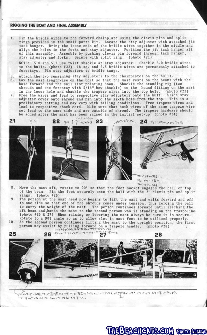

(@the-renovator)
Posts: 441
There is supposed to be a 10-hole stay adjuster attached to those "turnbuckles"
pic 21
That line is for some other purpose

i have the adjuster its on the forstay. do you have any idea what the line it for?

Yeah that is definitely not stock. Start from a stock setup and adjust to fit your taste later. If you don't have it, you will need a 10 hole adjuster to connect the bridles to the forestay. If you don't have the little steel triangle to attach the jib to the adjuster you can just use a bow shackle instead. Simpler is better at the start, then you can get fancy with things like portuguese turnbuckles, roller furlers etc etc.

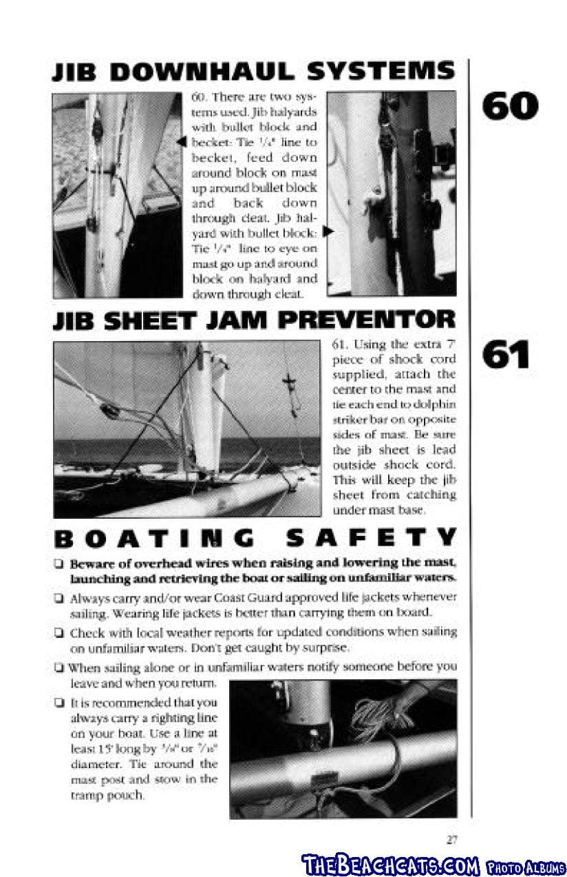

so i was looking at it today and found some more questions.
can some one describe the jib halyard, i thought it would be like my 16, but there is a block on the wire then the one end of the line ends at the block with a bowline the other end goes threw a v cleat.
that block is not supposed to be there right?
is that line and blocks on the boom supposed to be a boom vang? and do i tie any thing to the rotator bar?

The block is used to double the purchase on the jib downhaul.
Some used the block on the rear beam to double the purchase on the main traveler.
The boom is upside down. the line and block is part of your rotator and should be connected to the "rotator bar".

Do you have the two manuals from the Albums- Tech? Most of what you need is in them, though the photos are a bit grainy.
http://www.thebeachcats.com/pictures/?g2_itemId=35212
Jibs are item 60 in the second manual.
Posted : January 25, 2013 10:44 am

optikid wrote: can some one describe the jib halyard, i thought it would be like my 16, but there is a block on the wire then the one end of the line ends at the block with a bowline the other end goes threw a v cleat.
You aren't missing anything. Some boats had a wire block on the mast with the wire part of the jib halyard going thru that.
Some had the wire block off a pigtail on the fore stay. It sounds like that's what you have. I've hunted for a picture for you but have yet to find one. Look on page 8, standing rigging picture 2, you should have something like that.
