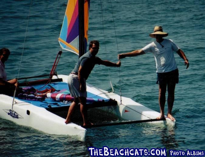

Front tramp on a 5.2 is a bad idea, not enough floatation in the front to handle it.
Posted : August 26, 2013 2:55 pm

http://www.thebeachcats.com/pictures/?g2_itemId=103791
click the link if the pic doesn't show
Posted : August 27, 2013 12:13 am

Thanks our point exactly. The 5.2 does not tolerate weight very well. If you think it does then we have to agree to disagree.

better than a hundred words
