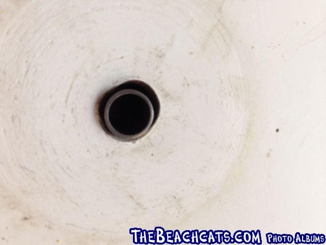

1. Pivot hole in blades worn and sloppy. Fill and re-drill? Use existing holes and pad insert with epoxy?

The pivot hole through one of the rudder blades is badly worn (first photo). The metal insert, which the pivot bolt goes through, falls out of the blade easily. It is massively sloppy, and I'm concerned this will be felt through the helm. The other blade's pivot hole/insert seems pretty snug still (second photo). Of all the slop issues (many more below) this one seams the trickiest to fix. I've heard of people filling the hole and redrilling it. What filler product would be used? Any other options? Could I just pack some epoxy around the worn insert and make sure its centered in the hole as it dries? Should I not worry about it at all? It's not a race boat, but there's so many sources of slop in the steering right now, and I'd like to address as many as I can without getting to deep into it.

1. You could use marine tex to clean up the sloppy-ness in those rudders, you can fill and drill, which is a nice off season project. I would probably use marine tex and the bushing and save yourself the drill operation.
Dremel out any loose material, also cutting away some material underneath the current fibreglass will give the new epoxy something to bond to. Do all boards at one time. Place a piece of 2-3" wide masking tape over the hole on one side, then flip blades over. Mix some epoxy,(fast hardener in this case)adding microfibres,(colloidal silica is a bitch to sand), to get a consistency similar to honey, you want it to be able to "run" a bit, peanut butter is to thick. Fill the hole, then push a 5" tight fitting bolt up through the tape,(wax the bolt, it will make removal easier).
You want the new hole to be true, so now make sure the blade is level by sitting a spirit level near the hole. Then turn the level 90* & re-level. Next, using a simple 9" carpenter square, check the bolt is actually vertical, then move the square 90* around the bolt & recheck for vertical. You will now have a hole that is perpendicular to the plane of the blade. After epoxy is "green", turn the bolt & remove, it will come out quite easy.

Cesar, thanks so much for your input. Re: Marine Tex. I'm trying not to buy yet another product. It sounds like great stuff, but do you think a good epoxy (which I have lying around) would work to pack around the bushing? Chris - there isn't any loose material, the hole has just been ovaled out. The more I think about it, it probably doesn't warrant redrilling, just filling around the bushing a bit. Some great other tips there also, thanks Chris

Agreed Tom, buying all of these things adds up quick and epoxy stuff is expensive.
I'm not a epoxy expert, so I'm speaking with limited experience, but in this case I would think that you would be ok using epoxy. Marine tex is pretty much the same thing but comes in white and is a putty consistency so a little easier to work with.
Based on that I think that you would get by with epoxy fine. Maybe with a little bit of filler to help with consistency and strength if you have any.
I'd personally try it. Worst case, you end up back where you are. But other than consistency and finish I don't think that marine tex offers better strength properties than normal epoxy.
I would remove a small amount of material, give it sort of a "V" shape, with the wide part of the "V" inside. This gives the epoxy more surface area to bond to, & the V prevents it from being pulled out.
