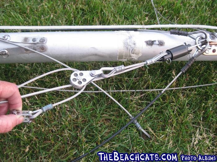

Sounds like you have the right idea with the jib. There should be a wire turning block for the wire jib halyard connected to the bottom of the upper swivel. I have pictures but can't get to them now, but here is a picture of the lower end, which is in my album.

Does this help at all, this is how I rig my roller furling. The main difference with roller furling is that you cannot use the wire turning block attached to the mast, up near the hound, that would prevent the sail from twirling. I removed the wire turning block & wire portion of the halyard, & substituted a small Harken block & 1 length of Spyderline,which holds jib tension via a clamcleat attached tot he drum.
I have the smaller boats, 5.7 & 5.0. They both rig the jib the same way, & I think the 5.8 is similiar.
Use forestay/shrouds to tighten rig. Jib is tightened by pulling halyard,(back down through the zippered luff, as Philip explains above) & tying off, or in my case cleating as its quick, & I single hand.
I think it goes the same as the 5.7....YMMV 😎

You should not have a cable at the top, that's probably the issue.
Cable at the top was the original setup on the 5.7, 5.2 & 5.0 Can't vouch for the 5.8, or other bridal foil boats, as I've not sailed them. If different, maybe a rig was substituted from one of the other Nacras?
The setup was;
captive shackle at one end of cable
cable
line
The line went up to block at mast hound,(pre roller furling the block was attached to the eye on mast in photo), around & down to cam cleat on mast. Attach shackle to cringle at head of jib, pull on line. With jib raised, the cable takes the downhaul load, & it is what is at the top. Here is how it would look rigged, jib would be attached to shackle in my hand, & when tensioned is about 6" lower than my hand.
I removed the existing line & cable with 1 piece of Spyderline.
Trappin, look through my album for the photo where a guy attached the head of the jib directly to the swivel. He used a marine eye at the top of his forestay, & a stamped shackle. That would eliminate the entire length of the pigtail, appx 10" in your case.
