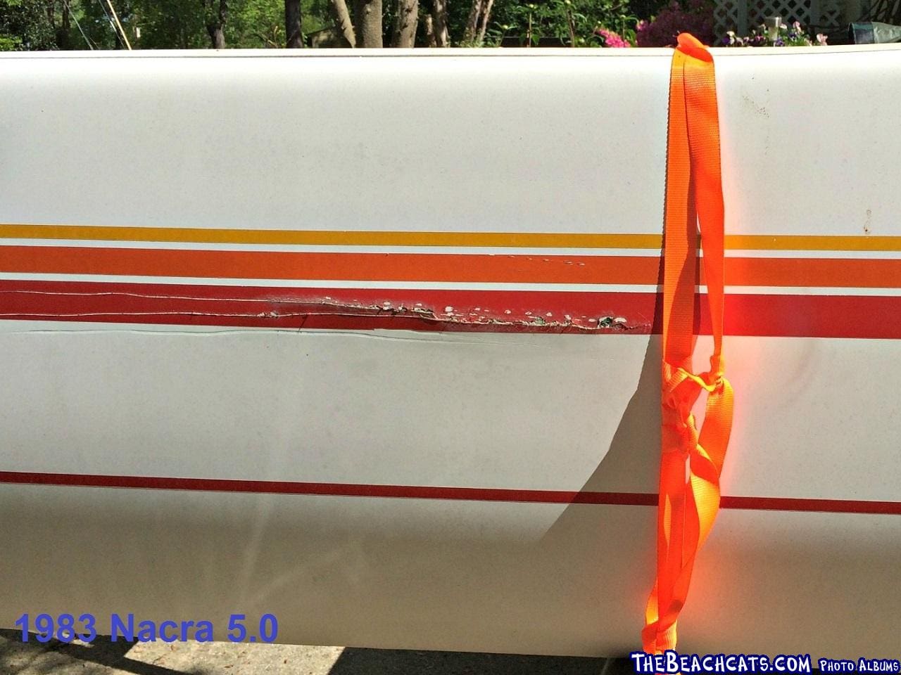

With recent fiberglass repairs to my 5.0, I had to remove some of the pinstriping. For now I'm touching up, not redoing everything. Questions:
My boat is a 1983 model of the red/orange/gold color scheme:

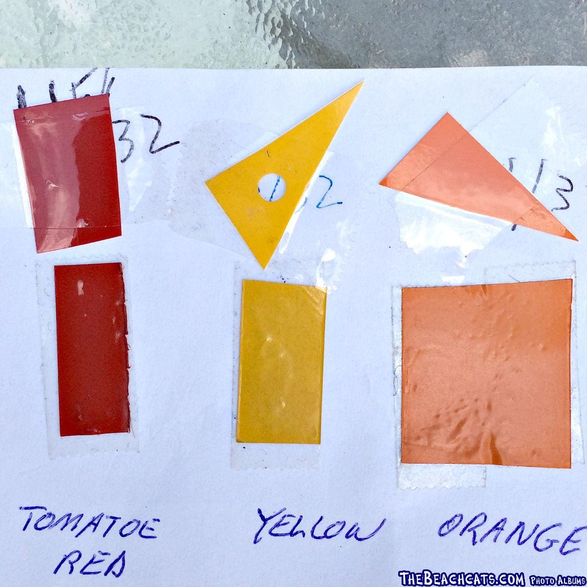

I contacted the folks Dave references above with no results on colors, fonts etc..
I did visit my local FastSigns shop and they had vinyl that compared as follows (top are their samples bottom are actual pieces of the stripes off my boat from the repair area)
Since I only need about a yard of each color, I will probably go this route for now. They thought about $ 15 would do it, cut to the widths I specify. I know this doesn't help much, but it's better than nothing.
