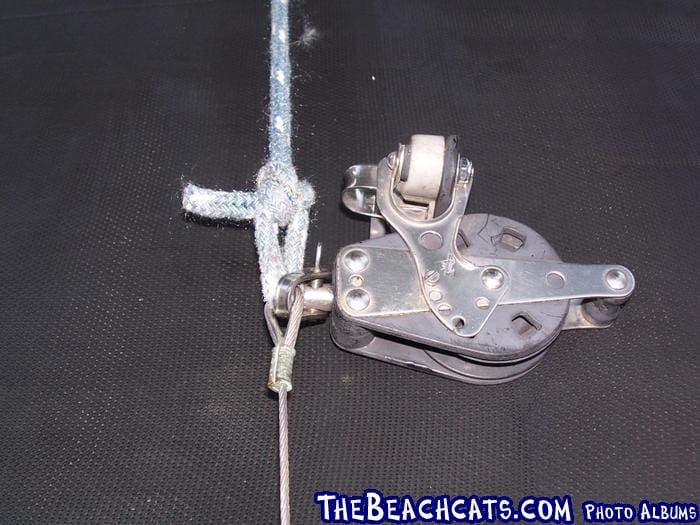

Jt, you lost us in your last response, and we understand that english is not your 1st language, so please be patient with us. The bridal wires are the 2 cables attached to the bow of the prindle using an anchor bar under the lip and a bow tang. The bridal wires are joined together using a bell shackle, usually the forestay is connected to the bridal wires at the bell shackle. The jib is attached to the forestay of the Prindle using the zipper pocket on the leading edge (luff), once the jib is raised and secured, then you attach the jib lines to the trailing corner (clew) using smaller clew blocks, at the clew plate. The jib lines are controlled by the jib blocks that are laying across the tramp.
Now if you were talking about the jib block bridle wire, also known as a "pigtail", look at pages 6 & 7 of the Prindle manual, notice that the pigtail wire is attached to the hulls through a small hole in the deck where there is a cutout in the tramp, newer boats have a port situated where the cutout in the tramp is located. In the pic at the top right of page 6, there is no port, so that must be how your P16 looks, page 6 explains how to join the port and starboard pigtails together using 3/16 line. If you can locate those small holes in the deck at the tramp cutout and there are no jib bridle wires, then you have a problem, someone in the past cut them off and to replace them if you have no ports will be almost impossible. You might just get lucky and someone pushed the pigtail back into the hull leaving just the thimble sticking out, if so pull the jib bridle wire out on both sides and follow instructions on page 6 & 7, but don't forget to seal hole where pigtail exits hull using silicone.
The jib blocks will then attach to these pigtails at the thimble as shown on page 7 with 1 small correction, the jib bridle wires are joined together using 3/16 line as shown on page but do not use a shackle, join them together directly at the thimble, the tear drop shaped loop on the end of the pigtail, the shackle is used to connect the jib block to the thimble.
If your jib block bridle wires have indeed been cut off sometime in the past, one suggestion will be to go with a tang and anchor bar setup to replace your pigtails:-
but you would have to relocate this pigtail anchor to the deck lip.

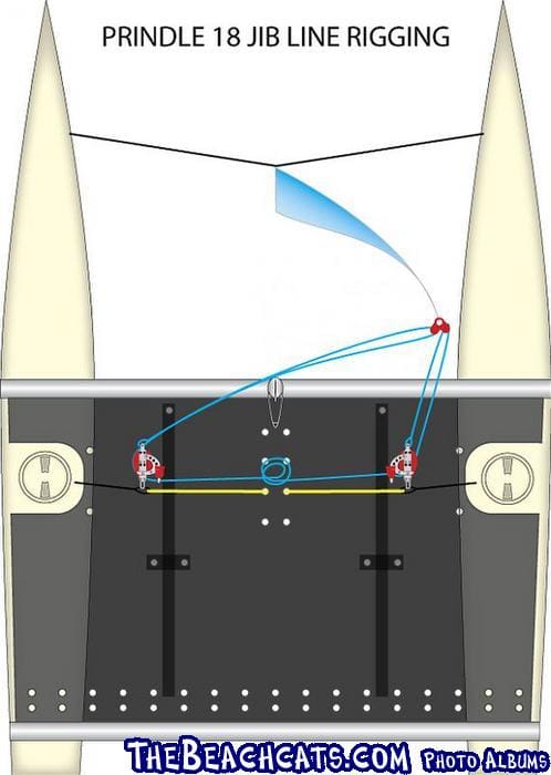

Does you 1977 P16 have ports just behind the from beams? My 1976 does not but I am not sure what year that changed. If you have no ports then you will not have a pigtail bridle that goes through the hull like everyone is telling you.
I do not have all the rigging for the 1976 P16 that I have so I cannot tell you exactly how it goes but I think that there are similar bridles that connect to the shrouds on the side instead of through the hull. Do you have any such small cables that came with it that could shackle to the shrouds?
Also see below for a diagram of the jib sheet layout
http://www.thebeachcats.com/pictures/?g2_itemId=76587
This is for a Hobie 16 but the idea is the same only the blocks are not on the beam.
Edited by Quarath on Jul 25, 2012 - 12:33 PM.
Posted : July 25, 2012 6:30 am

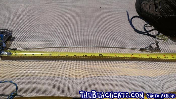

I also have the small cables.
Tell me how long those are pull to pull mine is missing them and I may need to make some.
Posted : July 26, 2012 7:28 am
(@p16rookie)
Posts: 11
Dustin, I will take a picture and measure it for you when I will be back home tonight.
JT
Posted : July 26, 2012 7:42 am
(@p16rookie)
Posts: 11
Dustin,
Here is the picture of the pigtail. When straightened the pigtail is 18.5 inches long excluding shackle but including loops:
Posted : July 27, 2012 5:32 am
