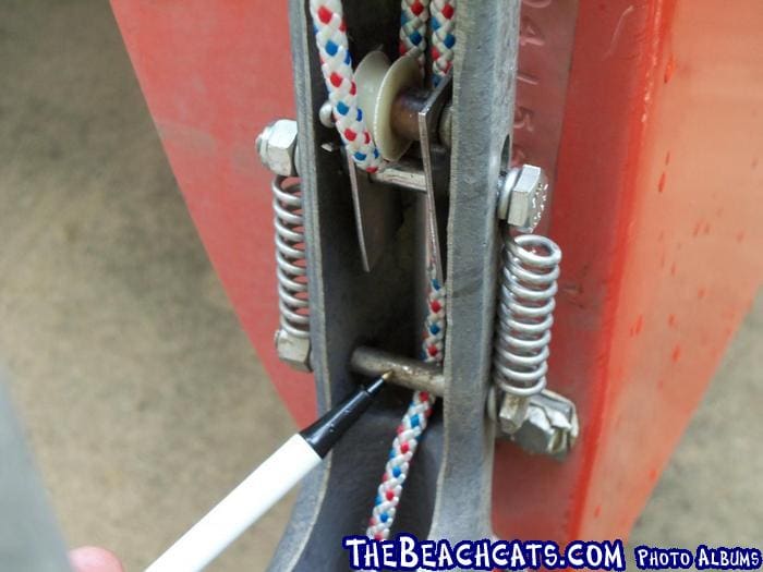

If all components in the rudder system are in good shape, the Prindle rudders are a proven system. The anchor pin and locking pin are straight, the locking bolt is straight and the lip on the lock-bolt is not worn, the springs are not stretched out, the half-round load spreaders are not cracked and decaying, the rudder lines are reaved correctly, the upper and lower rudder sheaves are in good condition and the rudder line is in good condition and is 5/32" low stretch line, all sheaves, upper and lower, have SS spacers, the lock release straps are setup correctly with the sheave and nylon spacer; the system will work. Why try improve on an already proven system?
anchor pin is straight...
locking pin is straight and springs are not stretched out....
the lock release mechanism is setup correctly with sheave and nylon spacer, when you pull on the "up" line, the tension lifts the lock-pin and frees the lock-bolt....
the upper sheaves are in good condition and spin freely, notice the SS washers between sheaves?
the rudder lines are reaved correctly, one on either side of the tiller connector bolt, 1/4" aluminum tubing makes good "T" handles, balls work ok.....
rudder lines are reaved in straight lines to their corresponding sheaves to eliminate binding....
locking bolt is straight, lip is not worn from incorrect alignment on locking pin and half-round load spreaders are in good shape...
Now go sail and stay away from kelp, try sailing further out into the ocean...... 🙄

the-renovator wrote: If all components in the rudder system are in good shape, the Prindle rudders are a proven system. The anchor pin and locking pin are straight, the locking bolt is straight and the lip on the lock-bolt is not worn, the springs are not stretched out, the half-round load spreaders are not cracked and decaying, .....
Excellent post and pictures renovator!
It's similar to the "problem" with the pre-1987 rudder casting system on the Hobie 18 with the metal cam.
The system worked perfectly fine while it was in good shape, the problem was after parts started wearing out. (20 years later) Unfortunately that system can't really be fixed once it goes bad. At least the Prindle system can be rebuilt.
