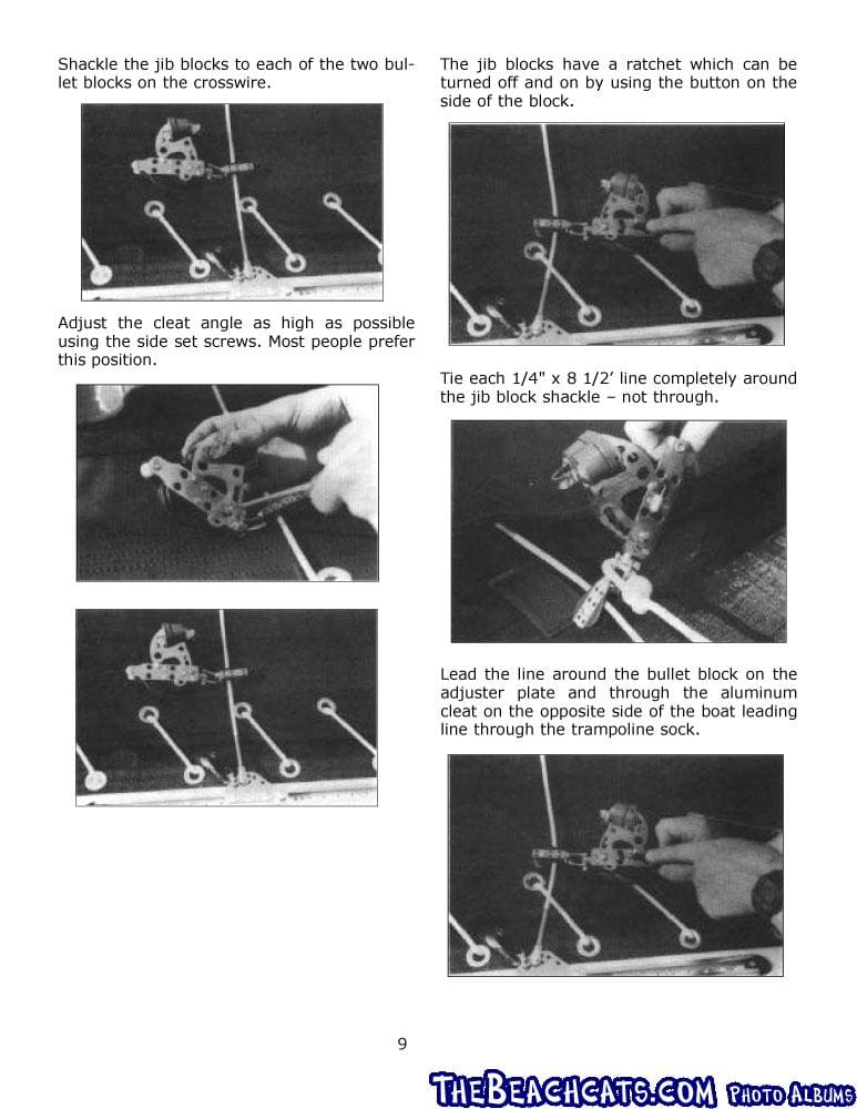

Here is a link to the original owners manual...
Posted : August 12, 2014 5:30 am
Posts: 4064
Quick view of manual pages here
http://www.thebeachcats.com/pictures?g2_itemId=35451
sample
Posted : August 12, 2014 5:58 am

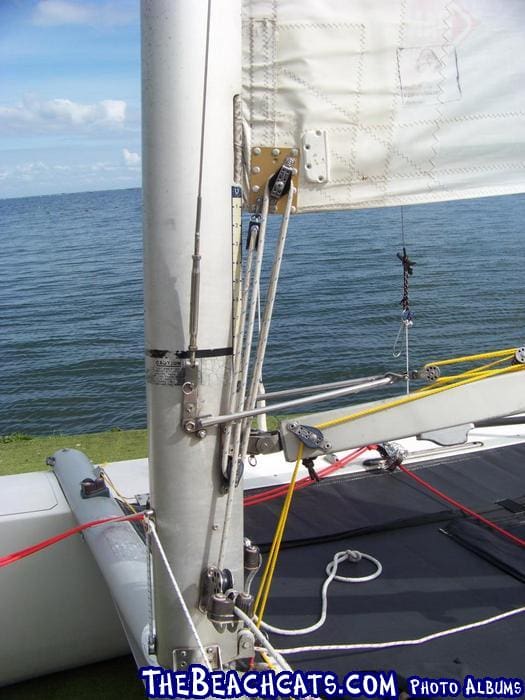

P19 questions- Does the down haul rope for the main slide through the Cam at the bottom of the mast? Where/how does the Jib halyard attach to the mast- didn't see a cleat? Where does the main halyard, that goes through that block at the bottom of the mast, attach to? lastly, if I am not using the four way jib, can I remove that pouch in the center of the tramp? Thx fellow sailors! 😕 😕
Posted : August 20, 2014 4:52 pm
André
(@catmodding)
Posts: 424
Here's a pic of the downhaul on my P18-2
The jib halyard is stored behind the zipper of the jib, its in the manual.
The main halyard is stored in the small zippered pocket on the tramp,
and should not be cleated or run trough a block.
Wise choice you made not using the 4-way system, it ruins your knees,
and sailing-suit.
You can ad a zipper on each side of that pouch and use it for extra
storage.
Regards, André
Edited by catmodding on Aug 21, 2014 - 07:13 AM.
Posted : August 20, 2014 6:12 pm

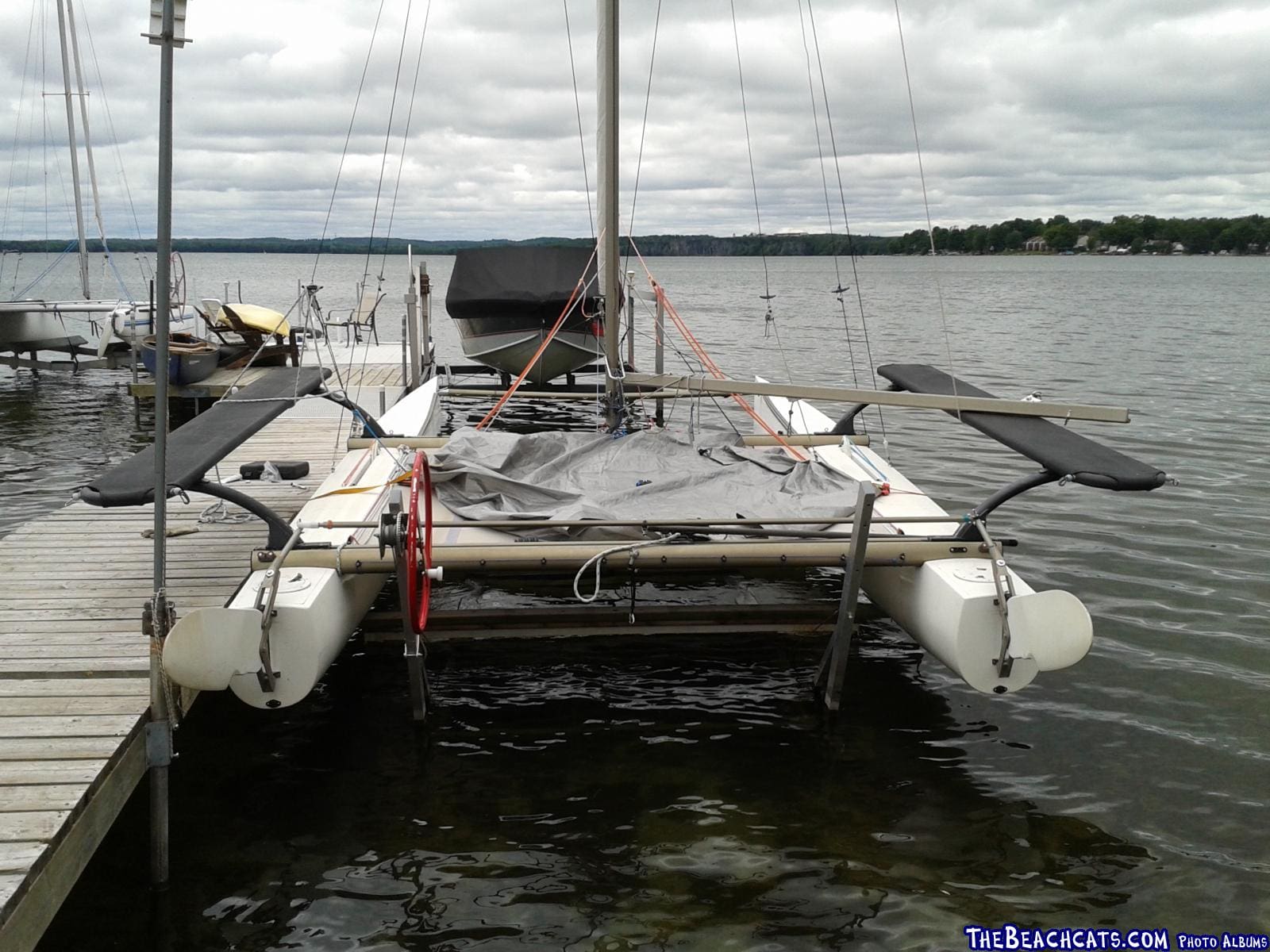

Posts: 2531
Usually tie 2' line with bowline to each block and then luggage tie line to clew. Or you can create this with a large shackle to your blocks and eliminate the line. Make sure you have enough jib sheet to do this.
Make it look like this,(click on photos to enlarge);
The red lines are the jib lines, you can see how they terminate via a short line attached as per davidsd above.
Remember, each jib line is a 2:1, & you have 2 of them. For every 1' you make that lead from the jib clew, you save 4' of jib sheet. There is a limit as you need to be able to fully sheet the jib before the small block runs into the jib block on the hull.
A better way, IMO is to attach like so:
This is how the Mystere 6 is rigged. the bottom line that goes to the clew is actually a long loop, the other line ends in a monkey fist. You put the end of the loop through the clew, then put the monkey fist into the loop, presto, jib attached with no knots or shackles to undo.
Edited by Edchris177 on Aug 29, 2014 - 06:18 PM.
Posted : August 29, 2014 12:18 pm

Nice Wings! Are those custom or is that an option on the Mystere?
Posted : August 29, 2014 1:20 pm
Posts: 2531
They are Hobie 21 wings, modified to fit the Mystere. If you can drag them in the water, you are already on your side.
They install, or can be removed, in about 3 minutes. It takes longer to walk to the garage & get the socket than to take them off.
