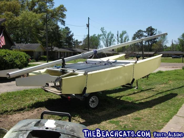

It is polyester, basically all the cats are polyester in the original layups. You should still use epoxy over polyester IMO.
I had a similar issue. I removed the gudgeon brackets, filled and faired the damaged area, then dropped aluminum plates on the outside with thin cork gaskets, and bolted the gudgeon brackets through the exterior plates, to the interior gudgeon plates. It's strong as hell and doesn't leak.
Most of the crap stuck to the hulls there is from previous owners' efforts at patching.
