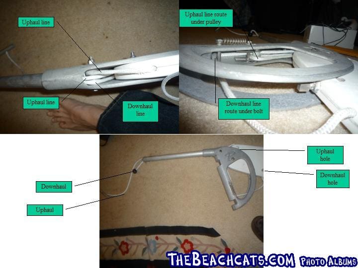

Anyone know how to rig the up and down pulleys on the rudder system. It does not seem to be in the manuel.

Ill take some pics for you tonight.

I have a new (to me) Prindle 18. I'm so close to sailing it I could explode at any time. I think I understand how the rudders are tied in, but I (hope to soon) trailer everywhere...do you have to take everything apart each time you tow the boat? It looks like there's no positive way to keep the rudders off the pavement sooner or later but to untie, unbolt, and remove them each time. Is that right?

I would take the rudders off when towing, even if they don't fall, they would vibrate and bounce, stressing the transom.
Will someone look at this and confirm I am not leading B24 astray?

I should add my lines are kind of thick, and don't move past the tiller screw very well. It was also very difficult to get them onto the three pullies in the picture on the upper left.
Next time, I would get some thinner, low stretch line. Someone else can chime in on a line recommendation. The line here is 3/16" (5mm) that comes with the Saltydog Prindle 18 cord kit http://www.saltydogmarine.com/product_info.php?cPath=421&products_id=3667 .
Frankly replacing the rudder lines sucks, be patient, have a beer.

I think your pics are right on the uphaul goes down and around so it can also pullup and and release the lock-down pin and the downhaul just goes down down around the bottom bolt as it only has to pull the locking pin into place.
I think you line is exactly the same as mine and I remember it taking a fair bit of finessing and cussing to get where I wanted it.
CAN I STRESS HERE!!
I have tried rigging these with a cheaper line.
DON'T DO IT
It needs to be high quality LOW stretch line.
I can't imagine a bigger line working don't know how they can go to 1/4. The holes are only so big.
