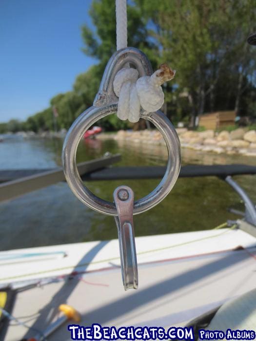

I had a 20' Mystere that gave me problems, (used the same sort of "hook" system), & I read every article, & Forum post, both here & Hobie Forum, with only limited success. The Mystere ring was this one, & it seemed the knot did matter.
When I changed the halyard from 1/4" down to 3/16" it was night & day, hooked/released every time.
When i got the H18, I tried every one of the various methods posted, including the Hobie article showing the difference knot forward/rearward.
The worst thing I ever did was try the advice to twist the ring a few times. That resulted in a sail I ended up leaving up overnight.
I now just use an anchor hitch on the basic Hobie round ring, & without any twists in halyard simply hoist the sail. You will feel it hit the top. Let it down a few inches, then give a solid pull. It will go up over the hook, & you will hear a "ting" as the ring goes over the hook & engages. On my H18 it's that simple, the only hassle is when the wind is blowing the sail against the shrouds, then it takes a couple of tries, or I wait for a shift & when the sail comes across, yank it up. This works 99% of the time, the final yank can be substantial, use gloves, of one of those line grippers.

This is the halyard ring you want to use. Just pass the halyard through the loop in the top and tie a basic overhand knot to secure it with the minimal amount of bulk. I agree that a 3/16" diameter halyard works the best.
