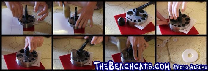

I took everything apart and rebuilt them as far as I can go. My wife made up a set of shim washers out of some Delrin sheet we had lying around:
I used these to shim the blades in their housings, and the tiller bars to the crossbar. There's practically no slop in the rudder/tiller system now. I can't wait to try this out on the water!
