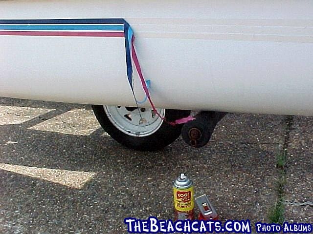

And this.
http://www.thebeachcats.com/pictures/?g2_itemId=11249

Thanks for the replies. So, one post says don't use goof off, it'll remove the gelcoat while another post shows someone using goof-off to remove stripes. Is there a consensus?

motivated wrote: Thanks for the replies. So, one post says don't use goof off, it'll remove the gelcoat while another post shows someone using goof-off to remove stripes. Is there a consensus?
There are a lot of different products in the Goof-Off line, all the ones I've seen list to be safe on Fiberglass, but read the labels.
