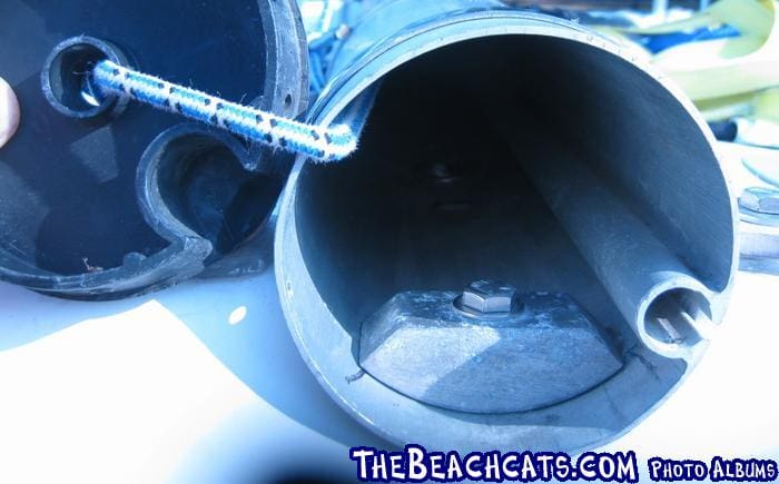

I took this boat to pieces when I first bought it, & again last winter for storage in the garage. It has the chocks. I placed witness marks inside the beam when I assembled it. The actual beam rotated, inside the straps, & chocks. The hole that is drilled in the beam to accept the chock bolts is quite large, you can rotate the beam probably 15* & still put the bolt in. When I set it up I oriented the DS rod vertical, then tightened things down. May be i needed more torque on the chock bolts. Looking into the beam, from the left side, the beam cannot rotate clockwise, as the chocks would run up against the track for the tramp. You would have to shear off the tramp track to rotate it. Going the other way, it is only friction, & the limits of the hole moving against the bolt that prevent rotation. I'm thinking the hole that accepts the chock bolt is purposely large so the factory never had to worry ab0ut critical tolerances.

The DS is out of focus in this photo, but you can see from the witness marks the movement that occured.
Here you can clearly see that the beam rotated counter clockwise until the edge of the hole came against the chock bolt. I don't know if the rotational force caused the deformation at the edge of the hole, or it was caused by flexing of the entire assembly during the last hour of sailing. The assembly manual makes no mention of the DS rod being exactly vertical, only to "rotate it to line up the hole", this leaves about 15* to play with.
